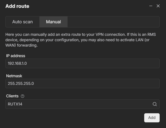

Could you please clarify which VPN you are using to access the device remotely?
If you are using the Teltonika RMS VPN Hub, please follow the setup instructions provided here: RMS VPN Hubs - Teltonika Networks Wiki
When adding a route, you can specify the entire subnet using the 255.255.255.0 subnet mask.
If you only need a route to a specific IP address, please use the 255.255.255.255 mask instead.

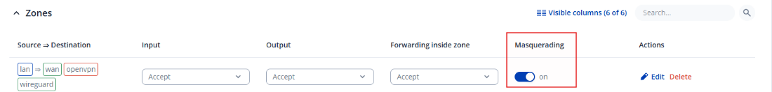

Additionally, please try enabling masquerading for the LAN zone. You can do this by navigating to:
Network → Firewall → Zones .

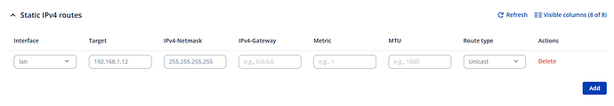

I changed subnet to 255.255.255.255 and masquerading to on under zones.
No change, I can connect to 192.168.255.10 and do get a hold of 192.168.1.12.

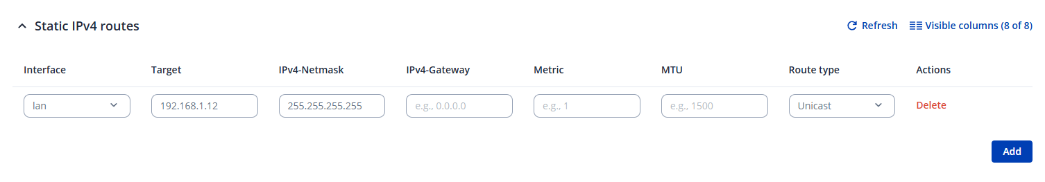

  3. More so, if you’re using RMS VPN Hub, please delete the Static Route you have in your WebUI, as that is not needed.

*Additional note - no port forwards, traffic rules & such need to be changed, at most, you’ll just have to enable Masquerading under Network → Firewall → Zones, specifically for the LAN=>WAN (first one in the list) zone.

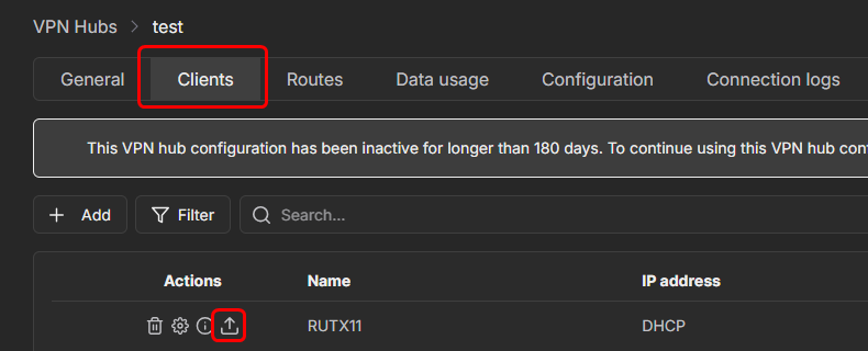

Please also try re-pushing the OpenVPN configuration onto your device from the RMS VPN Hub configuration menu:
