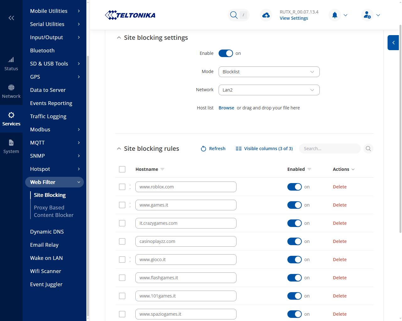

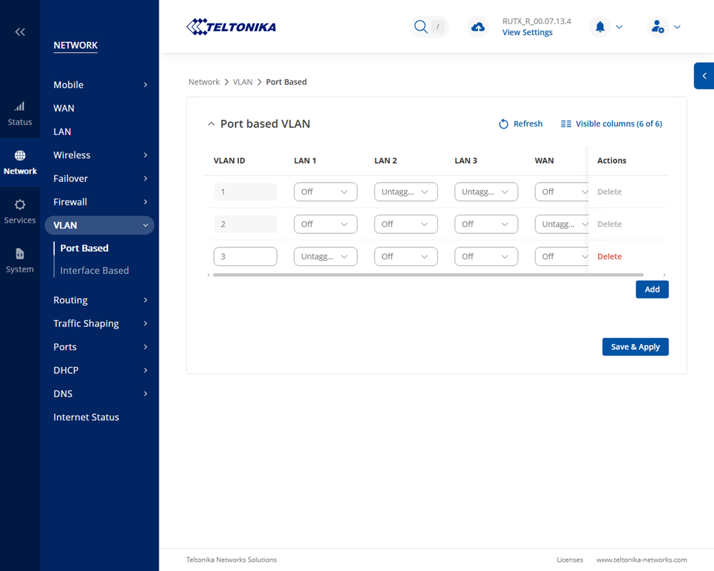

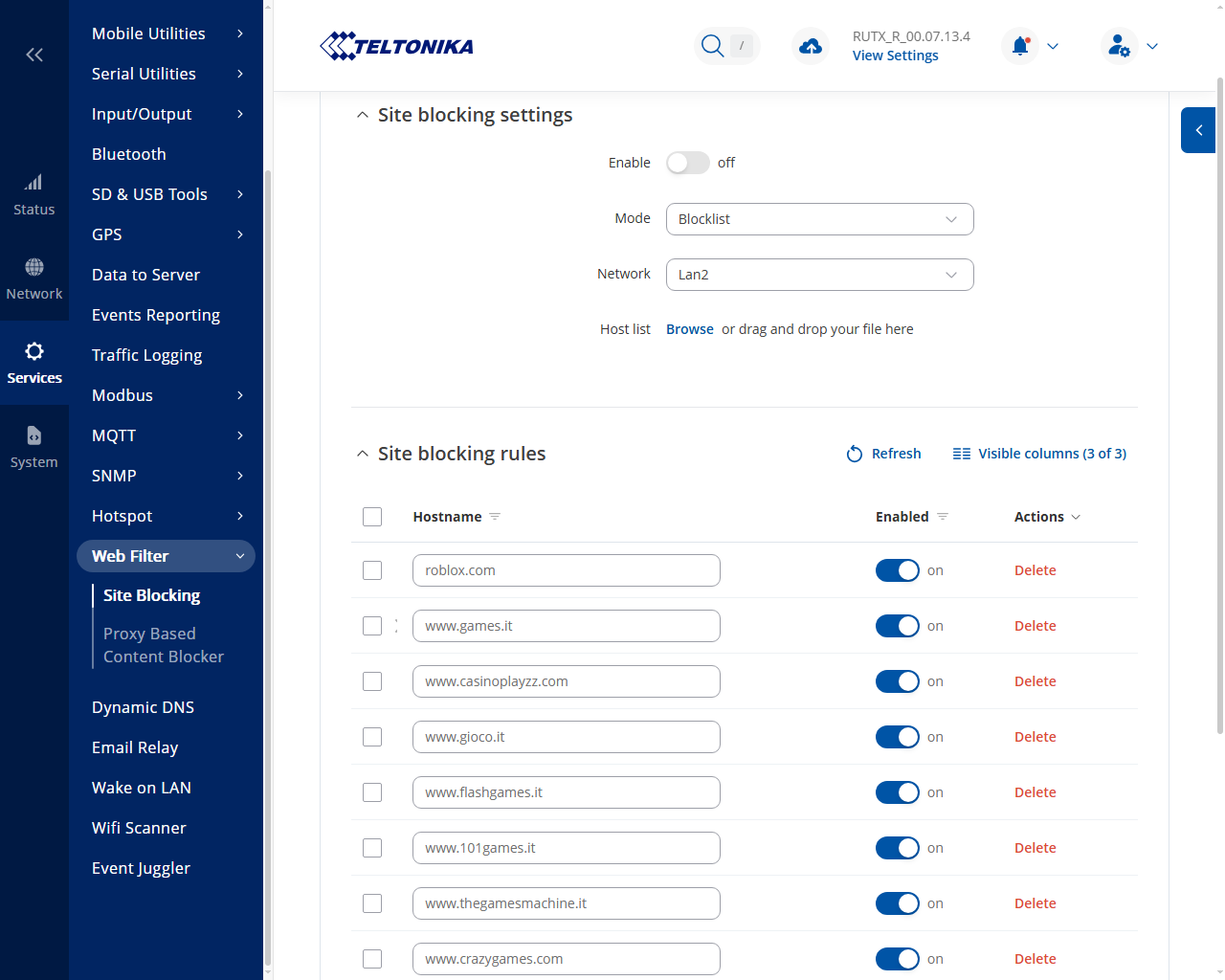

Hello Team, I modifeid port 1 vlan and I connect a new lan for some pc of my daughters. Everything runs good but not with site blocking. I made a list of site blockling for lan2 but it doesn’t work. They can use every site in the list !?!!?

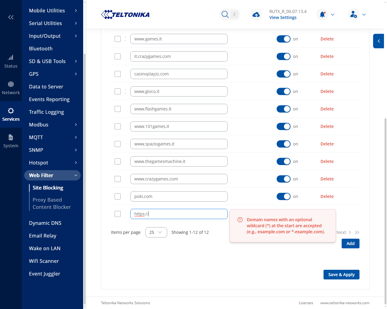

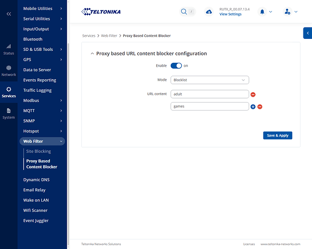

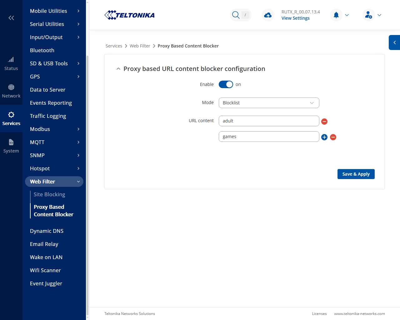

I tried with proxy based on content but it tells that I cannot block a site too, so I used site blocking for https but I cannot insert https because the system gives red error !!

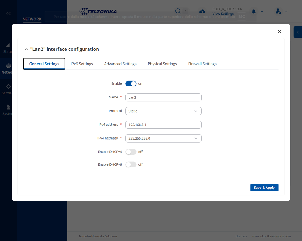

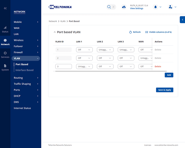

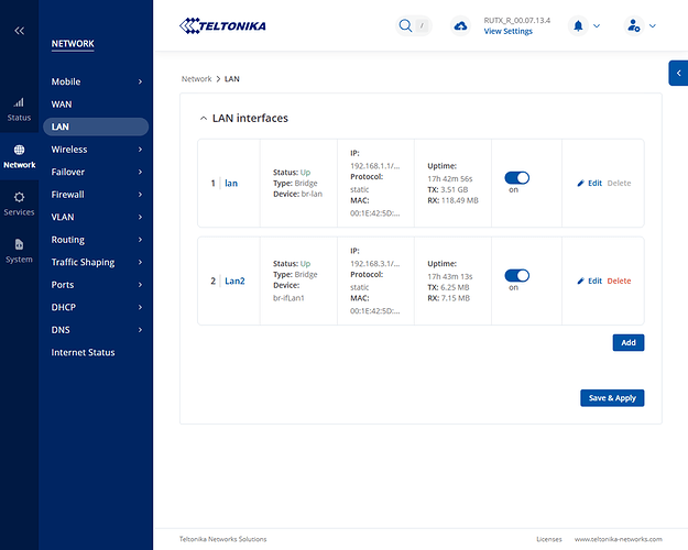

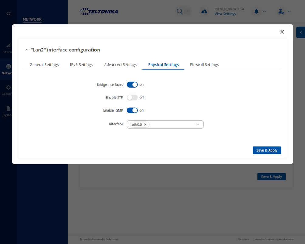

To begin, could you please provide a screenshot of the VLAN and LAN interface setting changes you’ve made to confirm whether there are no misconfigurations made?
I’ve tested the web filter in blocklist mode on my side, and everything appears to be working as intended, so reviewing your configuration might help identify any potential issues more accurately.
Regarding the proxy based blocker, it cannot be used to block HTTPS websites. For HTTPS domains, you should use site blocking instead.

Hello Martynas,
I send you my screenshot.
I recieve error even if I put https:// site on my lan/all lan interfeces…
-Regarding the proxy based blocker, it cannot be used to block HTTPS websites. For HTTPS domains, you should use site blocking instead. I used site blocking but it doesn’ t go. As I told you I recieve an error and I cannot use https:// site…

It’s expected and normal that http(s):// prefixes can’t be used in webfilter, instead, at the beginning, you should use www. or simply specify hostname.com (e.g. youtube.com) which’ll work properly.
Regarding your setup, could you unselect Bridge interfaces and enable the DHCP server on the Lan2 interface. Additionally, after making these changes, restart the webfilter service and check whether specified hostnames are blocked.
Note: Before checking web-filtered domains, you might need to clear the browser cache or test it in incognito window.
Let me know how it goes.
Yes Martynas, I unselected bridge interface on Lan2 and now the filter site is running. But now it blocks the site of school too, like axios !! Why ??? I don’t understand !!

  2. Is there a network switch connected? Since you are using port-based VLAN on port 1 for the web-filtered network, only a single end device (without a switch) could be connected directly to that port.

2 - yes, there is a switch network before the two PCs. I connect this two PCs by this switch but I don’t think to get enter inside this switch…it’s a very simple switch.
I mean, I get out from Rutx11 with port 1 as Vlan to have LAN2 and enter in this switch to connect two PCs. Every PC has a static IP address.

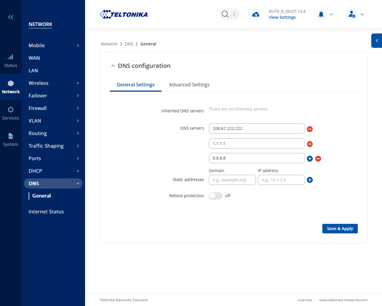

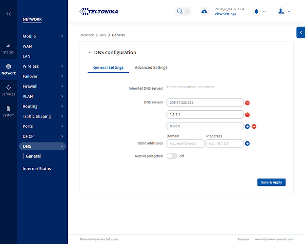

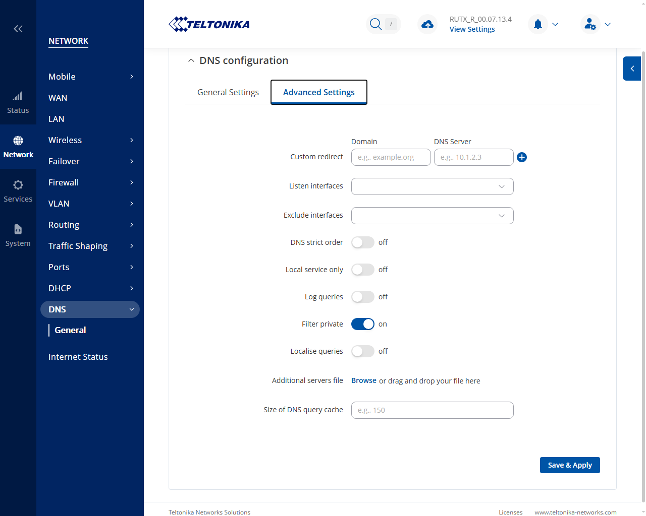

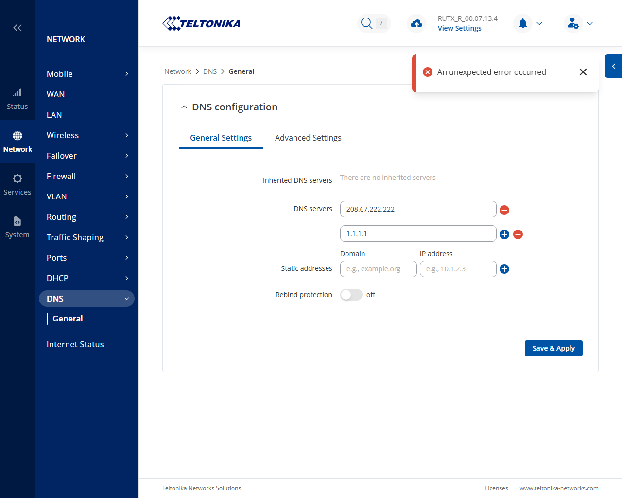

I find a iussue in my router config and I cannot fix it. I’m not sure if is it the problem…If I put 1.1.1.1 DNS in Lan2 they cannot navigate in some site (like Zanichelli) but if I change DNS with Cisco dns 208.67.222.222 they can use it. If I put dns in their PCs like gateway 192.168.3.1 they cannot navigate.

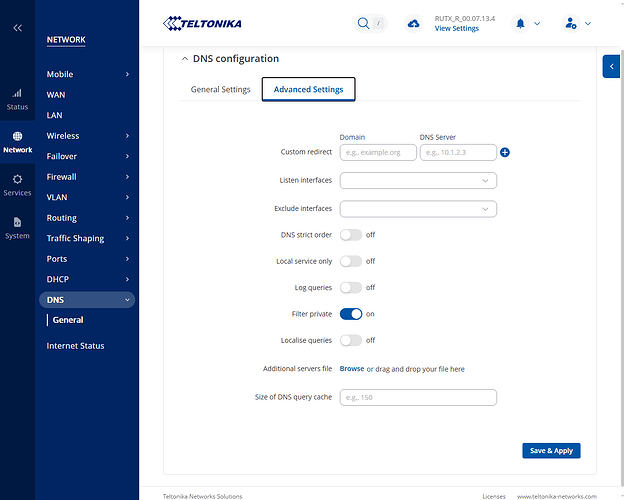

I send some screenshot

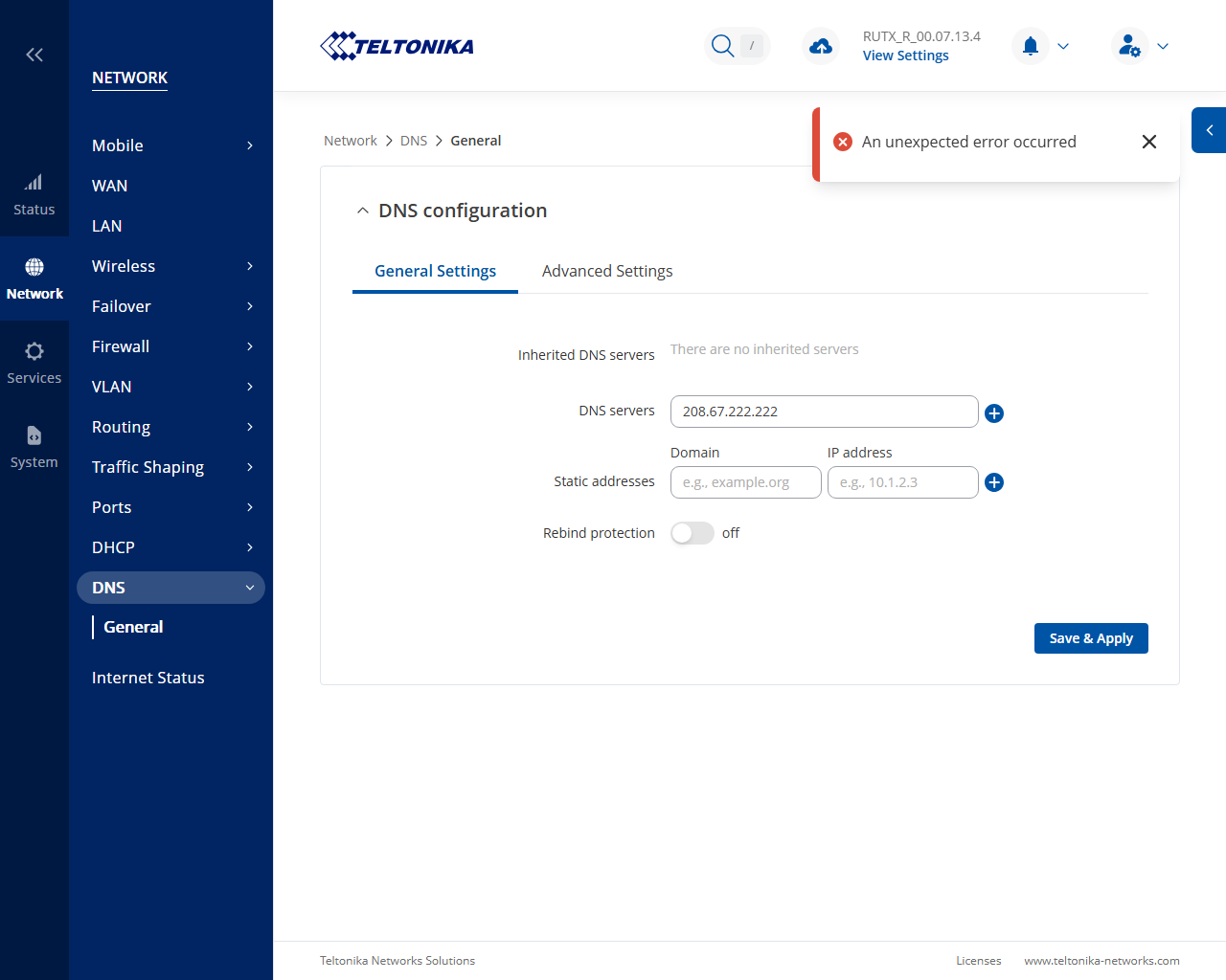

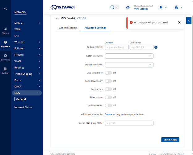

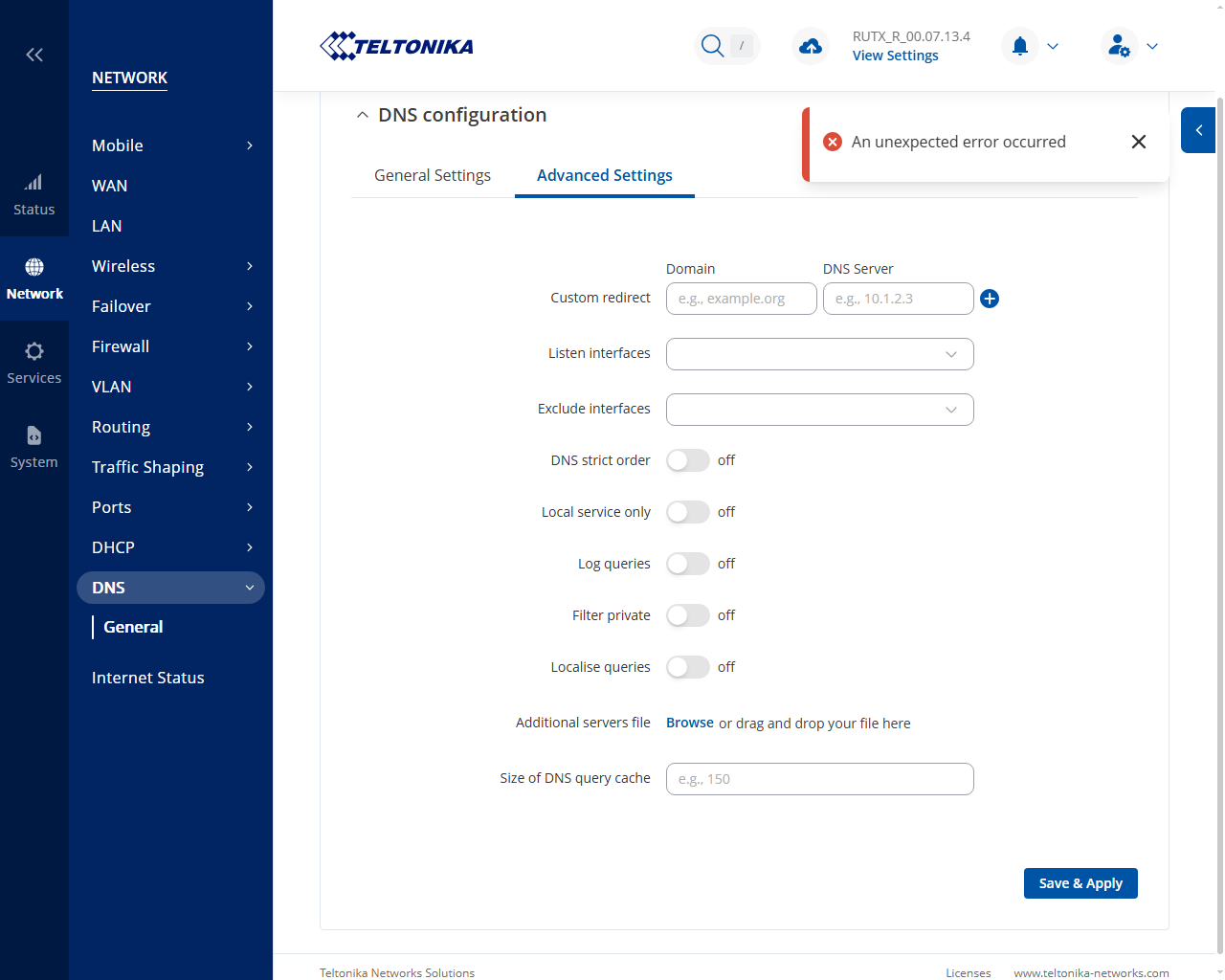

If I try to delete one dns I receive an error
And I cannot apply to save

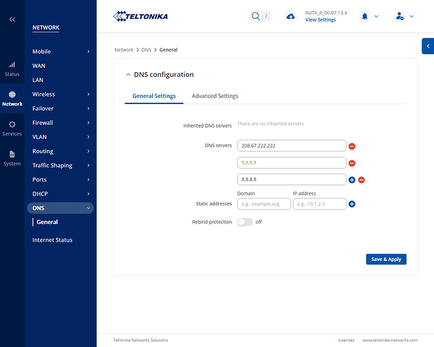

Every thing I try to change in DNS I receive an error
What do you think about it ? Can I solve it by CLI ? and how ?

If I understood correctly, you’re using a wired WAN connection (from the Cisco device) on your RUTX11 as your primary internet source. It’s a bit unusual that DNS servers are not inherited automatically from that WAN interface.
You could try setting 208.67.222.222 as a custom DNS server directly in the WAN interface settings via Network → WAN → WAN (Edit), then navigate to the Advanced tab and specify only that DNS server, avoiding the use of others like Google or Cloudflare.
This way, there’s no need to configure DNS manually on the PCs and on the router’s DNS settings page. Leave the DNS assignment on the PCs as Automatic, so they receive the Cisco DNS directly from the router (specified in WAN settings).
In brief, multiple DNS servers may interfere with web filtering and result in inconsistent behavior; therefore, you should remove them and test the configuration with a single DNS. Also, it’s a bit unusual why your router doesn’t receive DNS automatically from the Cisco WAN interface.

But I use the cisco dns (208.67.222.222) in my router and in every my devices and I don’t use dhcp because I have a lot of device connect (12 wired and 15 wi-fi) and it’s more fast to have ip static for everyone than dhcp server…
So, I explained that I cannot fix the iussue to delete the other dns, Network-dns-general
I sent screeenshot before. I don’t know why but I receive an error when I try to delete theme ! I asked you how can I solve it , if is it possibile by CLI

Thank you for the clarification. It might seem like the previously added DNS entries may be corrupted. As mentioned previously, webfiltering will only work correctly if a single, either inherited from the ISP or specified manually, consistent DNS provider is used.

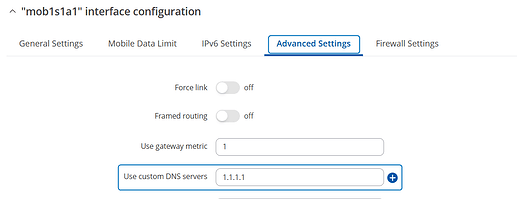

To move forward, could you try the following:
  1. Manually set a single DNS on your mobile WAN interface (e.g., 1.1.1.1) in the Network → WAN page by editing the mob1s1a1 interface in Advanced tab:
  2. On your PCs, leave DNS assignment to automatic;
  3. To verify that the router is using only the desired DNS server, check this with the following command via SSH/CLI:
cat /tmp/resolv.conf.d/resolv.conf.auto
This should show the currently active DNS server(s) used on the active mobile WAN interface.
Let me know how it goes!

I had already tried to do this, but it cannot remove the dns from general…yet.
I tried to reset the router and replace backup but nothing…
I tried to use automatic dns from wan mobile and I can see theme in general-dns and seems it use theme…
But I cannot remove the other one dns…
I don’t know how to remove theme. In the second page I cannot remove or change anytihg too that error appears…

Over all this I couldn’ t remove the multiple dns in general-dns…
I thought to erase theme from CLI command if is possible do it.

I found the solution causing impossibility delete dns. :slight_smile:
I had switch off the web filter site blocking and then I was able to delete the other dns in network-dns-general
