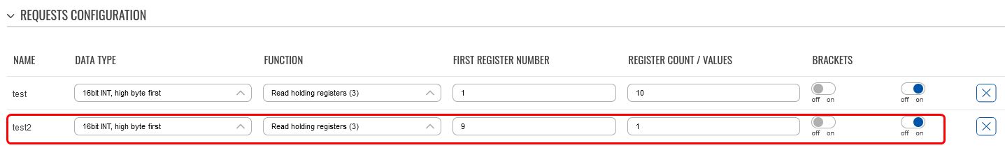

  1. Connect and set up the Teltonika device as the Modbus TCP/RTU Master. The third-party controller, linked to the Teltonika device, will function as the Modbus TCP/RTU Slave.
  2. To retrieve a specific register value, let’s say you’re interested in obtaining the value from register address 9. This is accomplished by configuring the request configuration settings within the Teltonika device. Refer to the visual representation provided below for clarification:

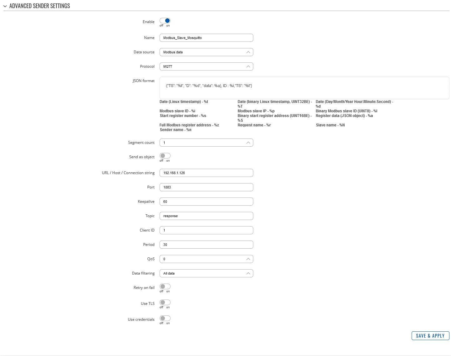

  3. After configuring the request settings, the next step involves activating the Data to Server feature. This action prompts the Teltonika device to send the value retrieved from the designated Modbus register to a predetermined MQTT Broker.
For example, the Teltonika device is connected to an MQTT broker at IP address: 192.168.1.126. The objective is to establish a data transmission frequency of every 30 seconds, where the Teltonika device sends data to this particular MQTT broker. To achieve this, the appropriate configuration would resemble the following:
MQTT Broker IP Address: 192.168.1.126
Transmission Interval: 30 seconds
Topic : response
For comprehensive information regarding the utilization of this feature, please refer to the following page:
Thanks and regards.
