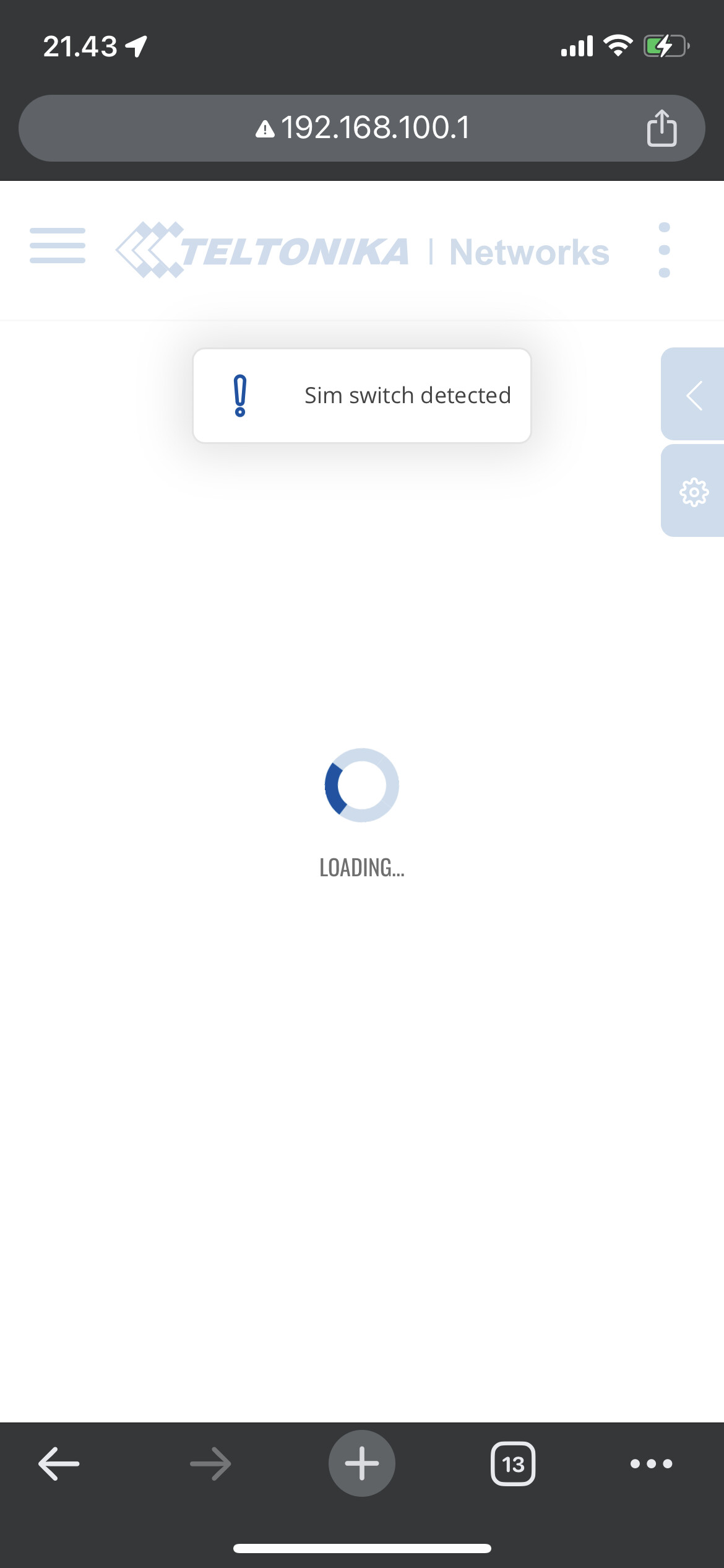

Sometimes when I’m having problems with the internet, i login to the administration system, and it gives me this error:
I don’t understand that it’s saying this, because i have not enabled SIM switching at all.

SIM Switch should only be initiated by the SIM Switch service. This service configuration can be found by navigating to Network → Mobile → SIM Switch. Make sure it’s disabled for SIM1 and SIM2.
If that does not help, please wait for the issue to replicate, then navigate to System → Administration → Troubleshoot, open the system log, and paste the past few minutes of the logs in your next comment. This may give us a hint of what could be causing the issue. It may also be related to the other issues you’re facing.
