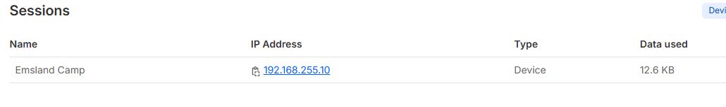

I followed the guide from the Teltonika Networks Wiki and applied all the settings exactly as described. As you can see in the data section (see attached screenshot), the device is reachable within the local network, and I can access the web interface without any issues.
The device in question is a Janitza UMG604.

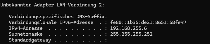

However, I’m unable to access it over VPN. Even a simple ping does not go through once I’m connected via VPN.
Do you have any idea what might be causing this?

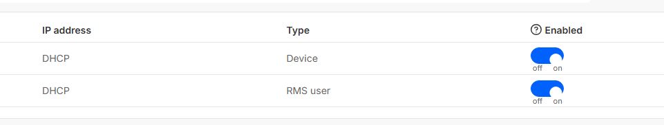

could this be the Issue?
