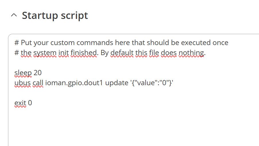

  1. If the issue still occurs even on the latest firmware, you can try setting the output to “low” by default after boot-up using a custom script. To do this, navigate to System → Maintenance → Custom Scripts, and add the following to the Startup script section:
sleep 20
ubus call ioman.gpio.dout1 update '{"value":"0"}'
This will set the output to “low” 20 seconds (can be changed to a higher amount) after every device boot-up.

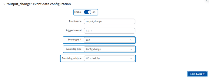

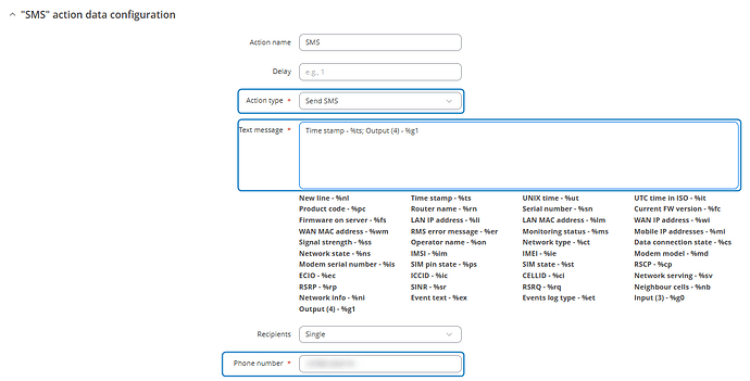

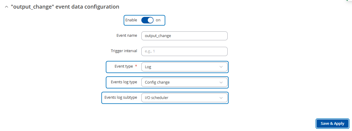

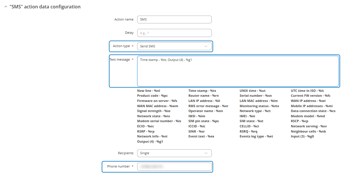

  1. To send SMS notifications on RUT200, output change can be achieved pretty simply by using the Event Juggler feature. The Event Juggler configuration setup for this could look similar or identical to the one provided in the screenshots below:

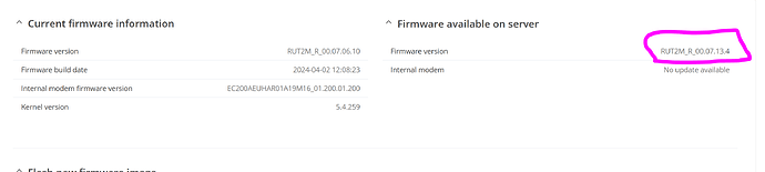

Unfortunately, I only managed to try it out now because the router was on a remote mountain top.

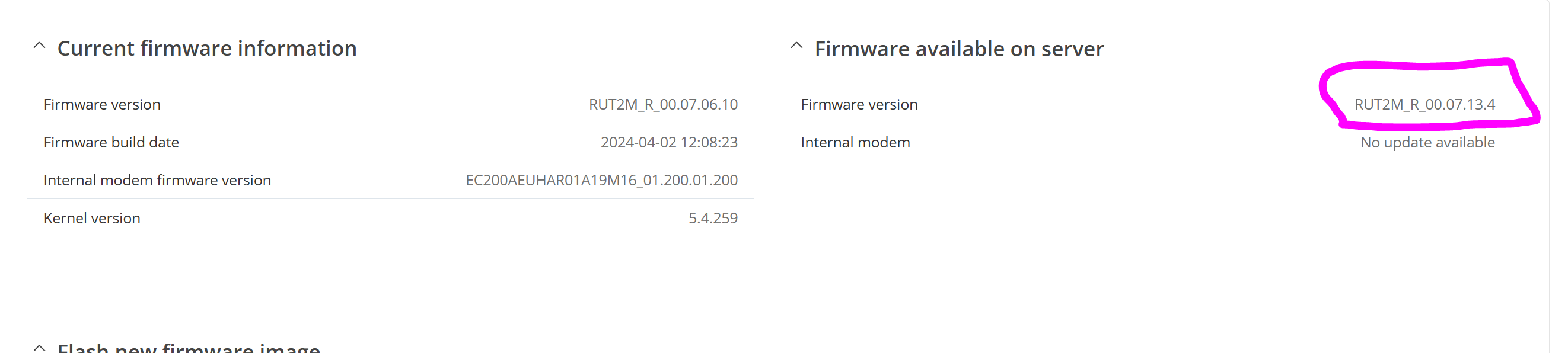

I already had the firmware on the latest version.
See screenshot:
The user-defined script for automatic switch-off after booting worked right away :slight_smile:

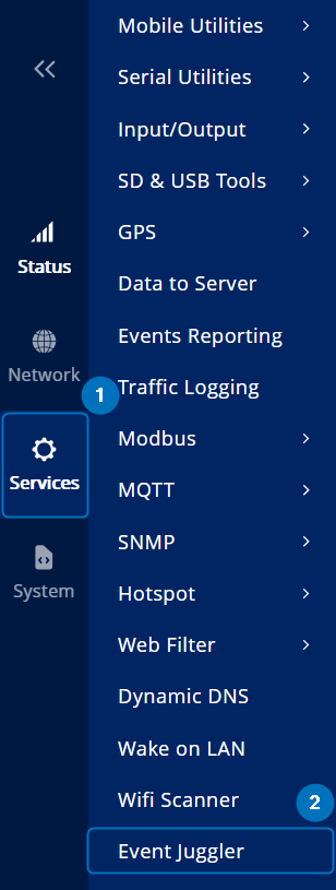

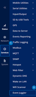

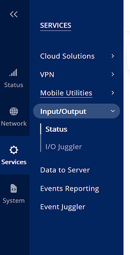

Regarding your question, the Event Juggler feature should be available in the WebUI under Services → Event Juggler page.
Event Juggler's location
Could you please check and confirm if you see this service?

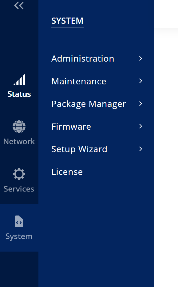

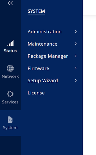

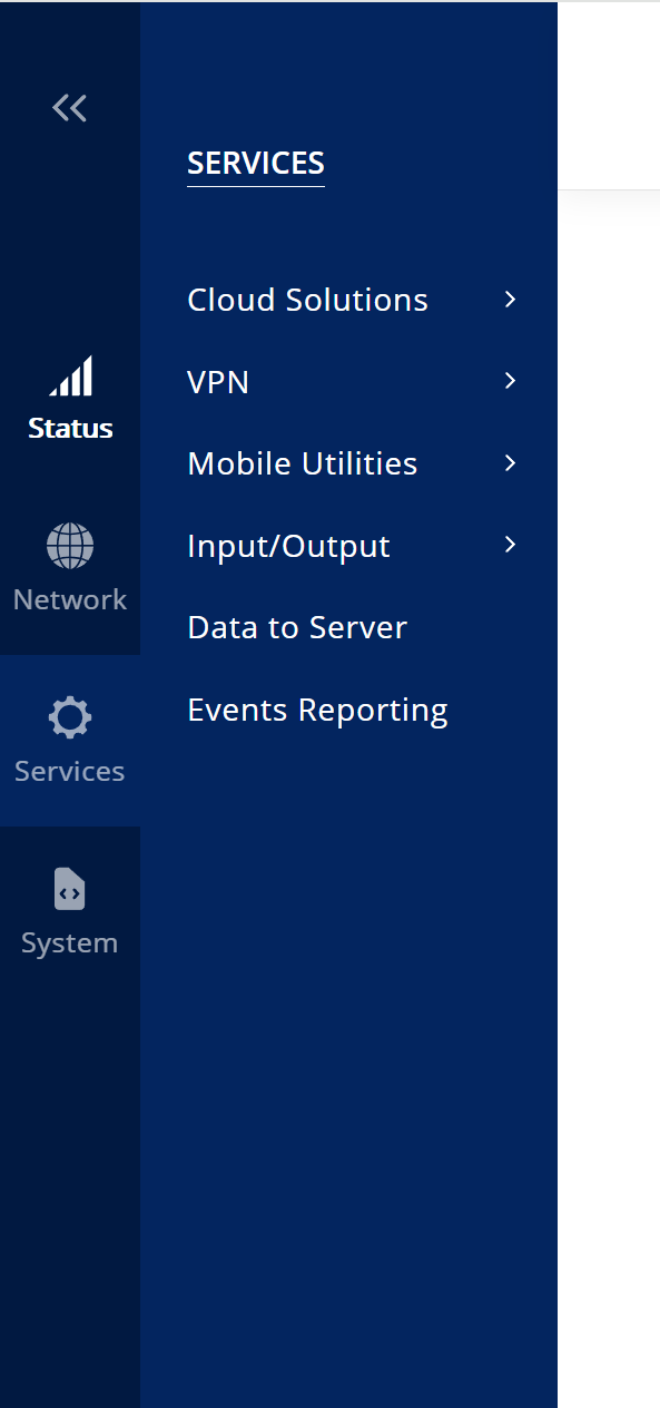

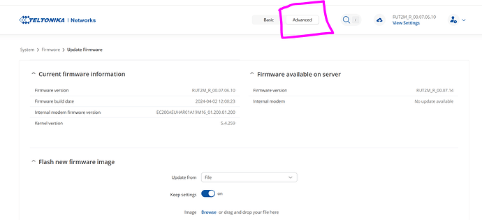

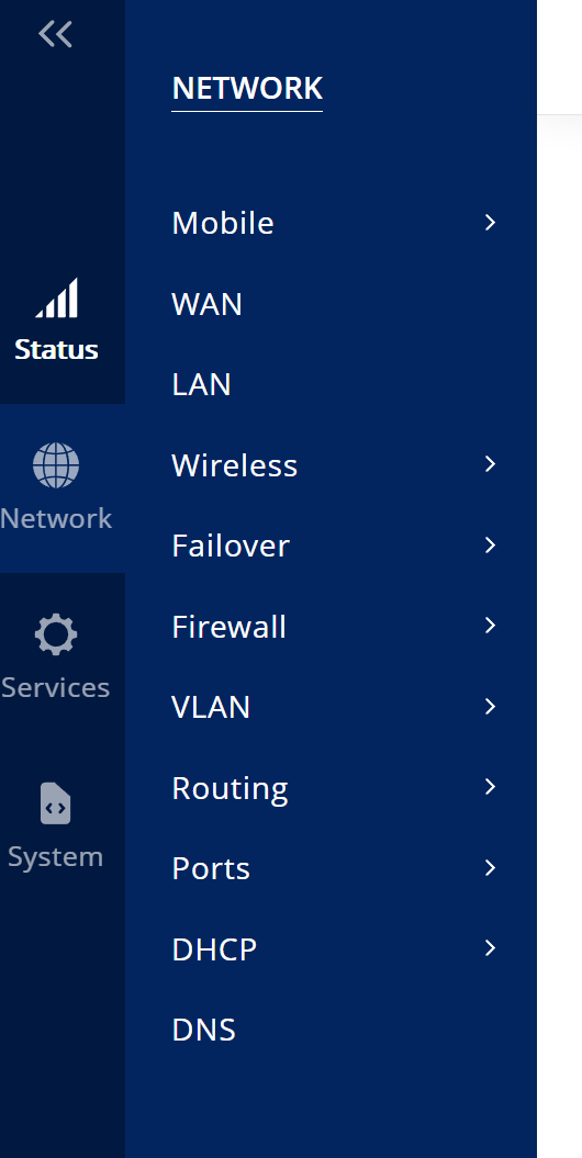

I’ve looked to see what I have under “Service”, but unfortunately I have far less options.
This is a screenshot of my RUT200 web interface:
I have also switched on the “Advance” mode:

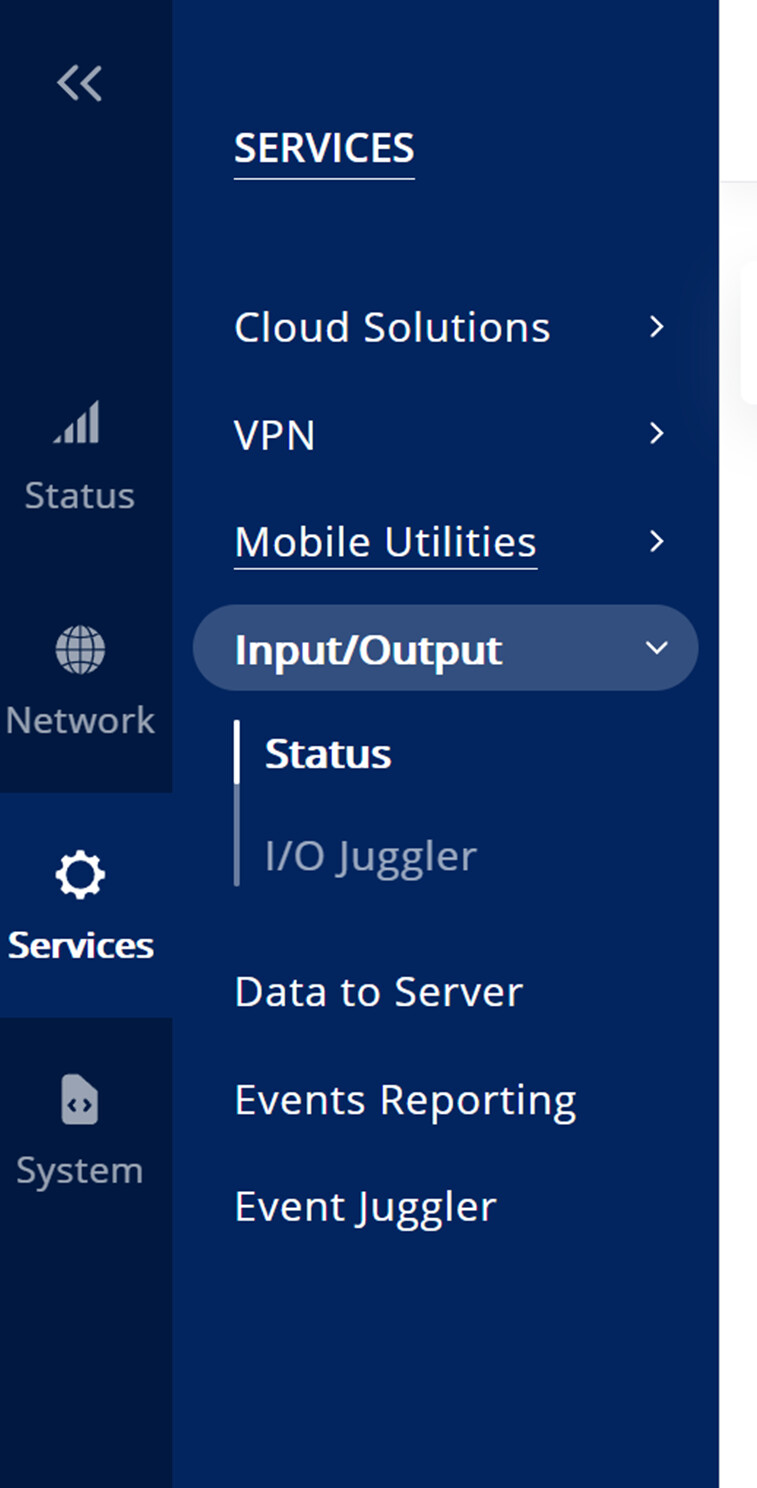

Shame on me, I’ve now found my mistake as to why I didn’t see the Event Juggler.
When I checked the firmware version, I had looked at the available version and not at the current version :frowning:
Sorry that was my mistake!!
Now I also see the Event Juggler :slight_smile:

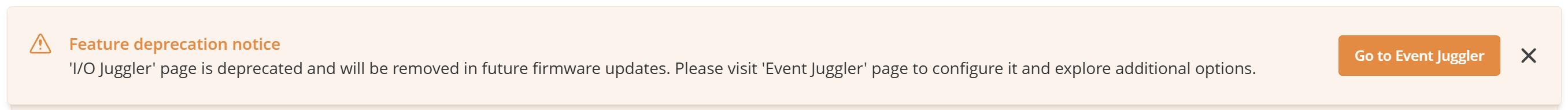

The new firmware gave me this warning:
Should I move the functions out of the IO Juggler and into the Event Juggler within the next few days, or do I still have several months to do this?
Thank you for the update.
Regarding your question: for now, if you prefer, you can continue using the I/O Juggler feature. However, please keep in mind that it is planned to be deprecated and fully replaced by the Event Juggler in future firmware updates. While there’s no exact timeline known for its removal, it’s likely to happen with 7.15 or one of the following releases, so you probably have a month or two before any mandatory changes.
If your current I/O Juggler configuration is working as intended, you can stay on it. That said, it is recommended to gradually migrate your configurations to the Event Juggler when convenient to stay aligned with future updates and benefit from its extended functionality.

Unfortunately, I noticed that after updating the firmware version, the script for switching off the output on restart no longer works. (The output is switched on automatically after a restart)
The script currently looks like this:
Does something have to be modified by the firmware update?

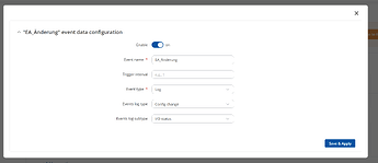

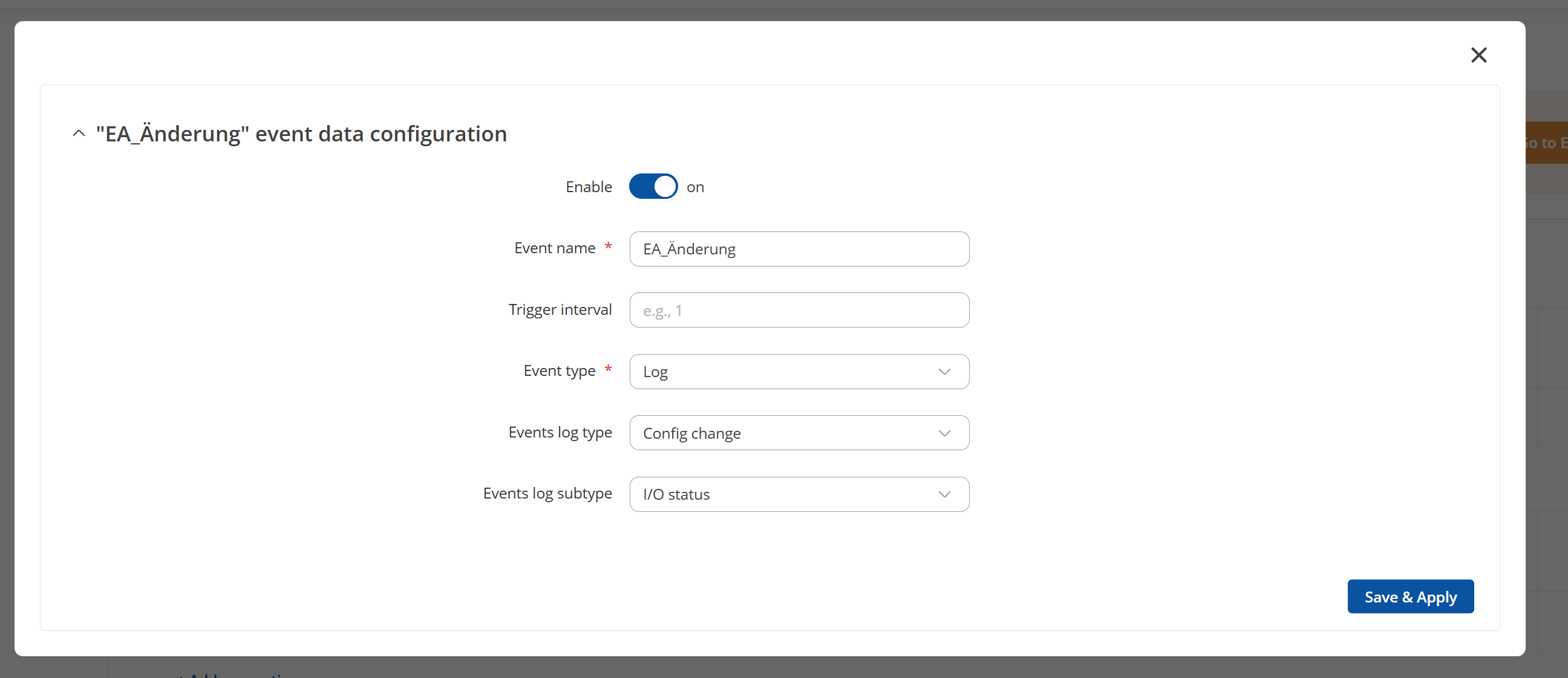

My task was to receive an SMS from the router via the Event Juggler when the output was switched (regardless of which action triggered the switching, e.g. SMS, call, etc…).
When I wanted to create the event in the Event Juggler as described by you, I can unfortunately only select io-status and not io-scheduler. Unfortunately it does not work with io-status.
Here is a screenshot of mine:
Am I doing something wrong again or is there another way?

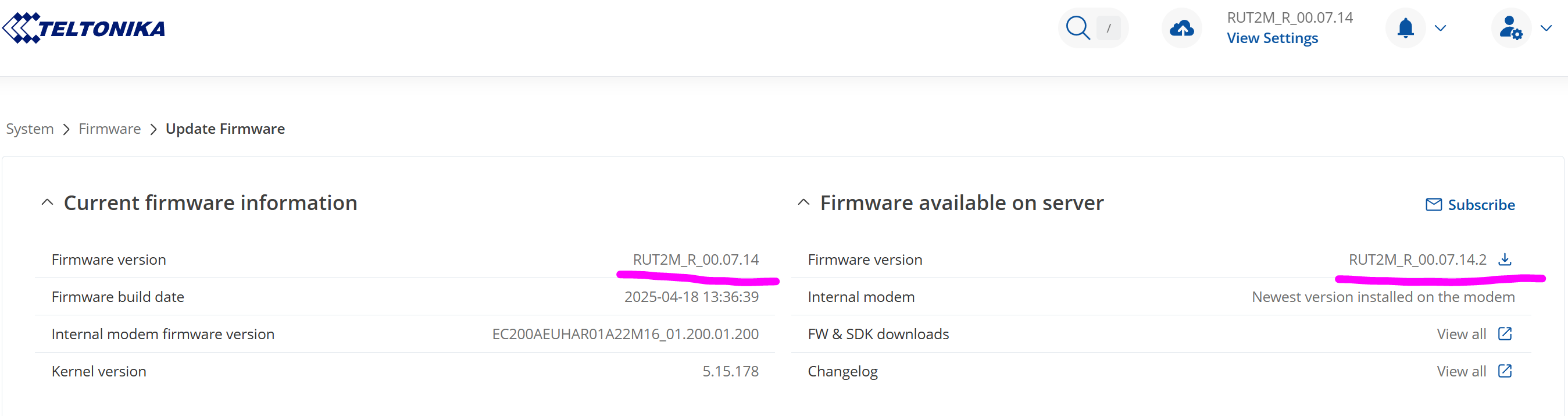

To which firmware version was the device updated? 7.14.2?

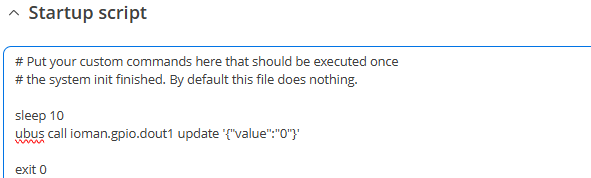

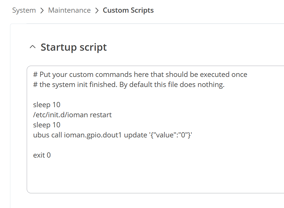

Additionally, try the following startup script:
sleep 10
/etc/init.d/ioman restart
sleep 10

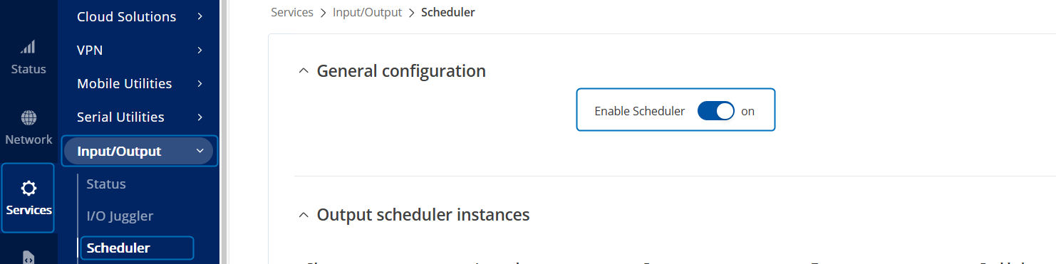

and make sure that the I/O scheduler is enabled in Input/Output → Scheduler settings:
Then it should be visible in the Event Juggler’s settings.

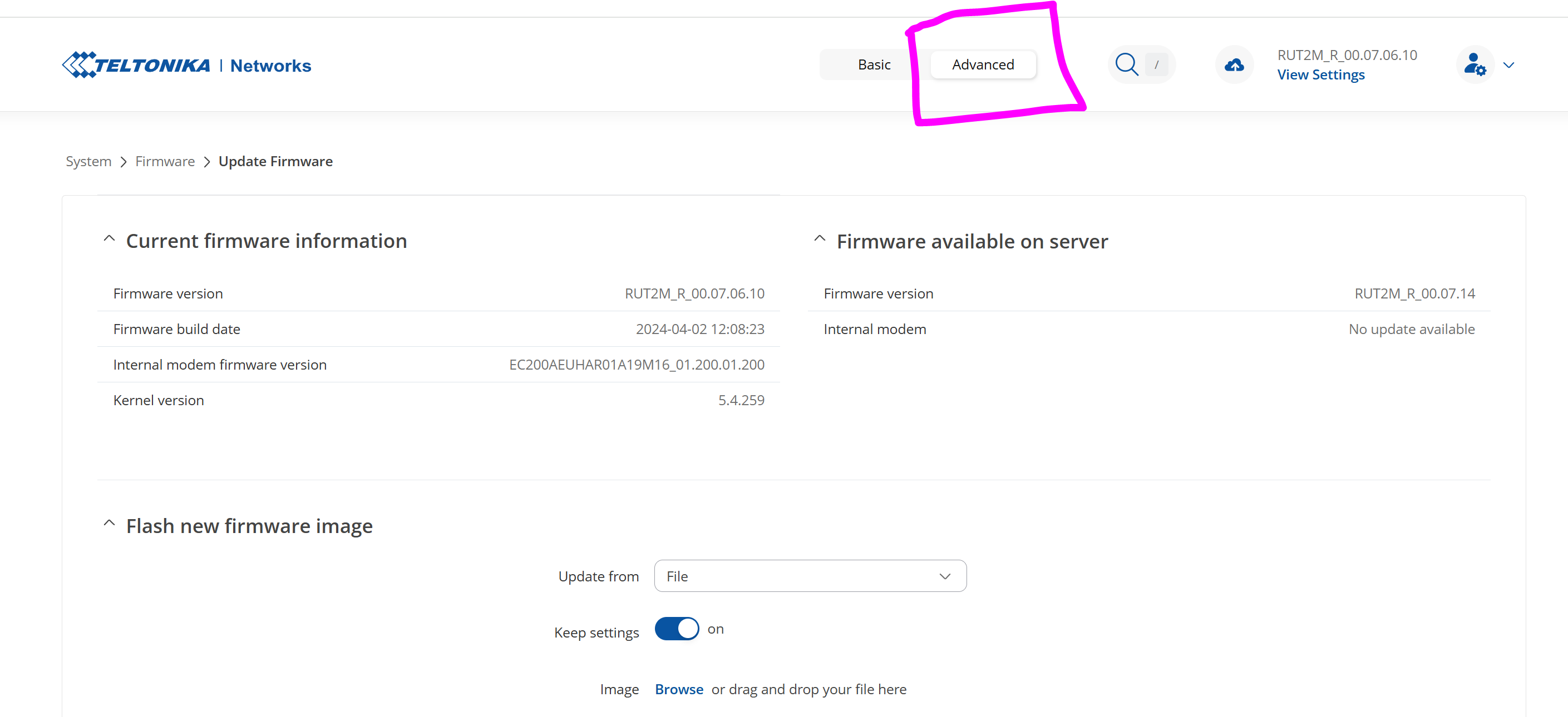

I can confirm that I have the firmware 7.14.2 (see screenshot)

I have now changed the startup script as follows, but unfortunately it didn’t work either:

At the beginning I could not see the scheduler either.
( but I thought I had seen it before the firmware update)
See screenshot:
After I installed the Scheduler package, I found the scheduler. I also activated it, but unfortunately it does not yet appear as an option in the Event Juggler
See screenshot:
Do you see anything else that I have done wrong?
