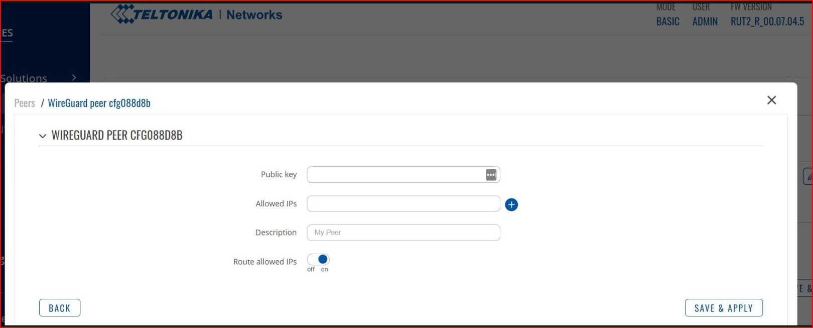

I downgrade to ver6 becuase when I was on the latest version7 according to the system firmware check. I don’t have the option to enter the Endpoint Address. The following field are not available.

I was trying to explain that the latest version firmware doesn’t have the option to enter endpoint address/host. See picture below the comparison between the versions.
this is legacy version
In the upper-right corner of the WebUI, click on ‘Basic’ mode to switch to the advanced mode. You will see more options.

Thanks for the help. The new firmware and the Advance mode change was what I am missing, did a rough test and it worked.
