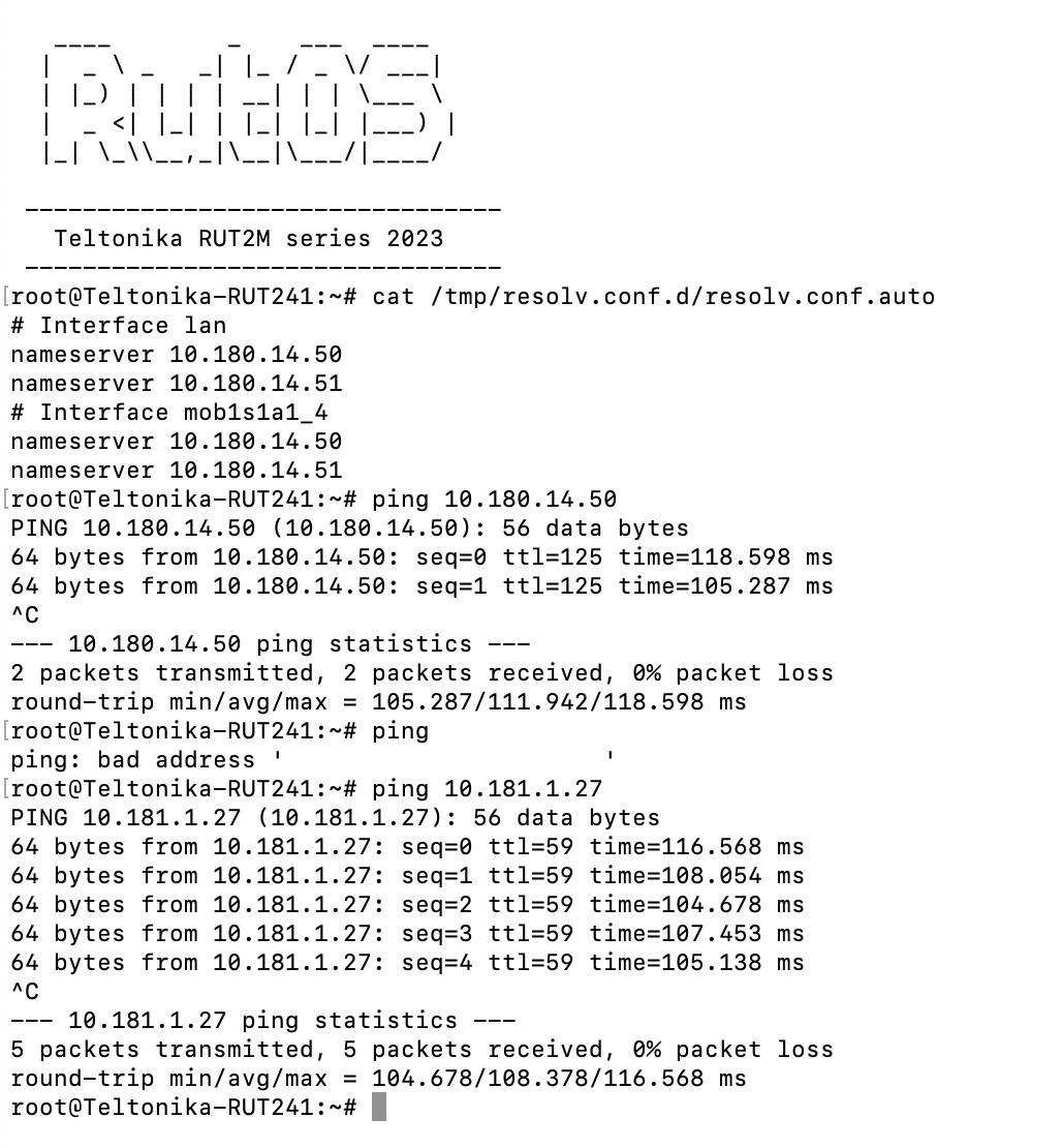

On the resolve.conf auto I have the DNS servers specified:
So it should be correct? Yet still, if I try to ping the service using the DNS name on the client, I get unknown host.
Also trying to ping the host straight from the router fails (bad address). Pinging using the services IP works both from the router and from the client.
