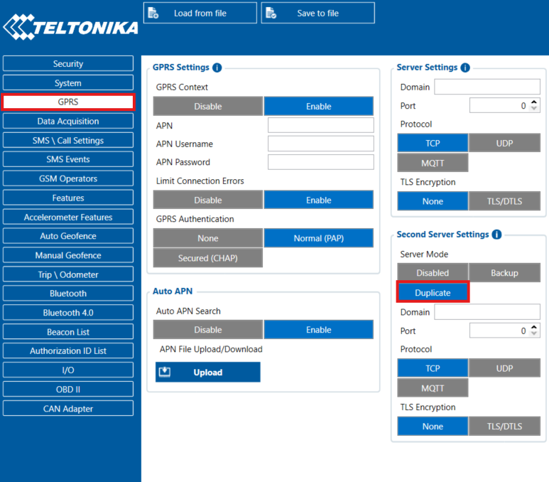

The device is not sending data to Server 2. I have configured the Server 2 domain and port, but no data is being received from the device. Do I need to activate another parameter, or should it work as is?
Hello @khaled.Bri,
I hope you are doing well. Did you manage to set the Secondary server to Duplicate? It’s essential to configure it this way; otherwise, the device won’t send data to the secondary server if it’s set to None.
