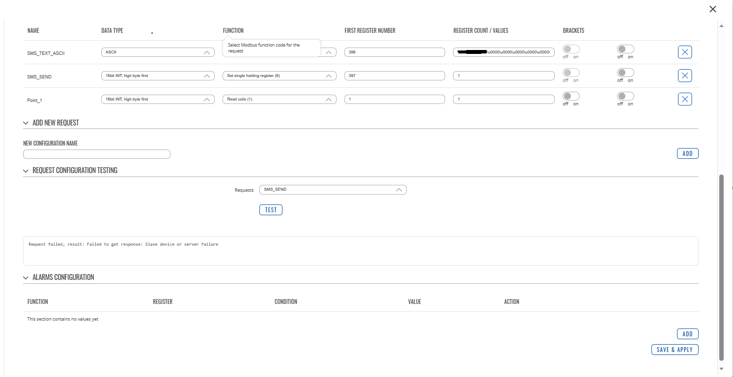

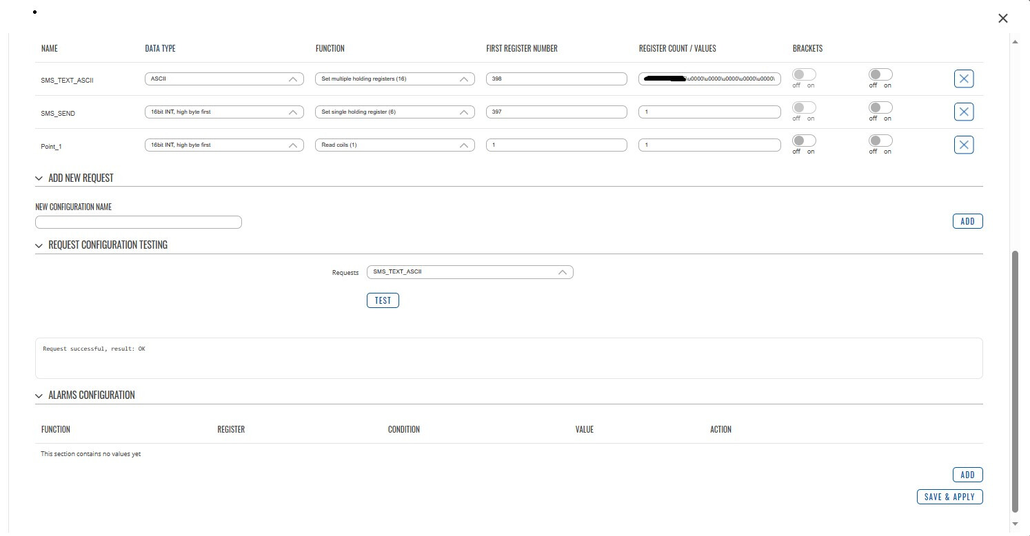

Thanks for the answer, Now I can write content to register 398, but I can not write the “send command” by setting value 1 to register 396 (also 397). It says: Failed to get response: salve device or server failure. Is it caused by the newest firmware 07.04.5?
Could you please help me with what wrong is?

here some picture that I tested
The error can be a result of invalid information in the SMS registers. Maybe the phone number is incorrect or the format is wrong? For example, if you are writing with HEX, the values should start with ‘30 30’ which is basically ‘00’ or ‘+’ that you need to specify before entering the country code and the phone number.
