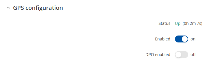

I did an identical setup as yours. I’ve set up a mock HTTPS server to send the information to.
GPS configuration is enabled under Services → GPS:

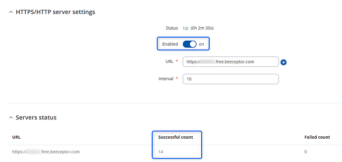

I’ve then simply inserted the link to my web server and enabled the forwarding:
As you can see, the requests go through successfully:
Perhaps try to remove the port to see if that helps you out? Additionally, ensure that the firmware version you’re running is the latest available for your device as of this date.
