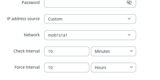

I have connected the WAN to a router that I have no control over. My internet traffic goes via WAN and the mobile interface is intended as fail over/for access to my router from the outside. But it only reports the IP address of the WAN, Router which I have no control over. When I turn off the WAN, it sends the IP address from the mobile interface instead. But as soon as I activate the WAN again, it sends the WAN IP address again to the DNS server.
DDNS service protocol is custom.
