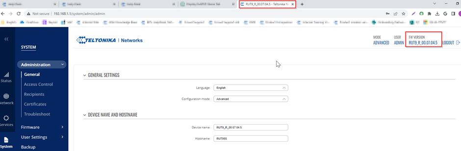

If not, I have formulated a UCI command for executing it router by router through the command line.
firmware_version=$(uci get system.system.device_fw_version)
uci set system.system.routername=“${firmware_version}”
uci commit system
/etc/init.d/system reload
