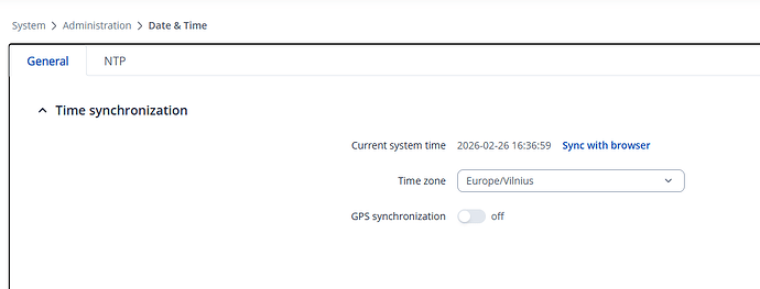

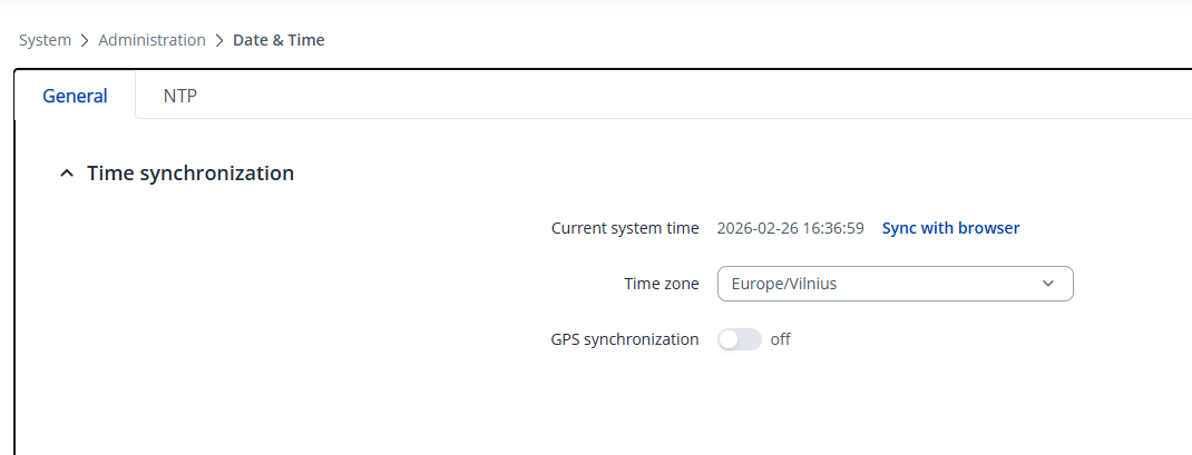

First, make sure the system date and time are synchronized. Go to System → Administration → Date & Time.

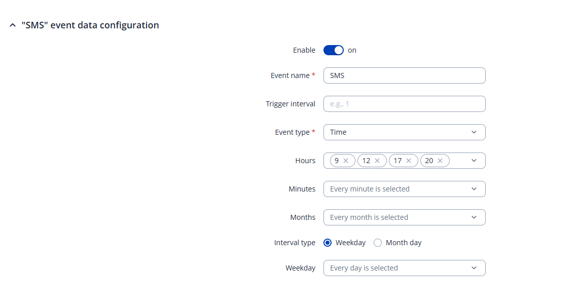

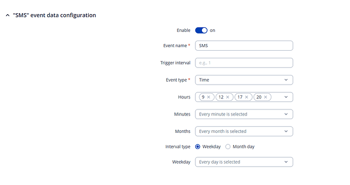

You can use Event Juggler to send SMS messages periodically. Navigate to Services → Event Juggler and click Add.
Enter an event name and set the Event Type to Time. Then select the hours when you want the SMS message to be sent.

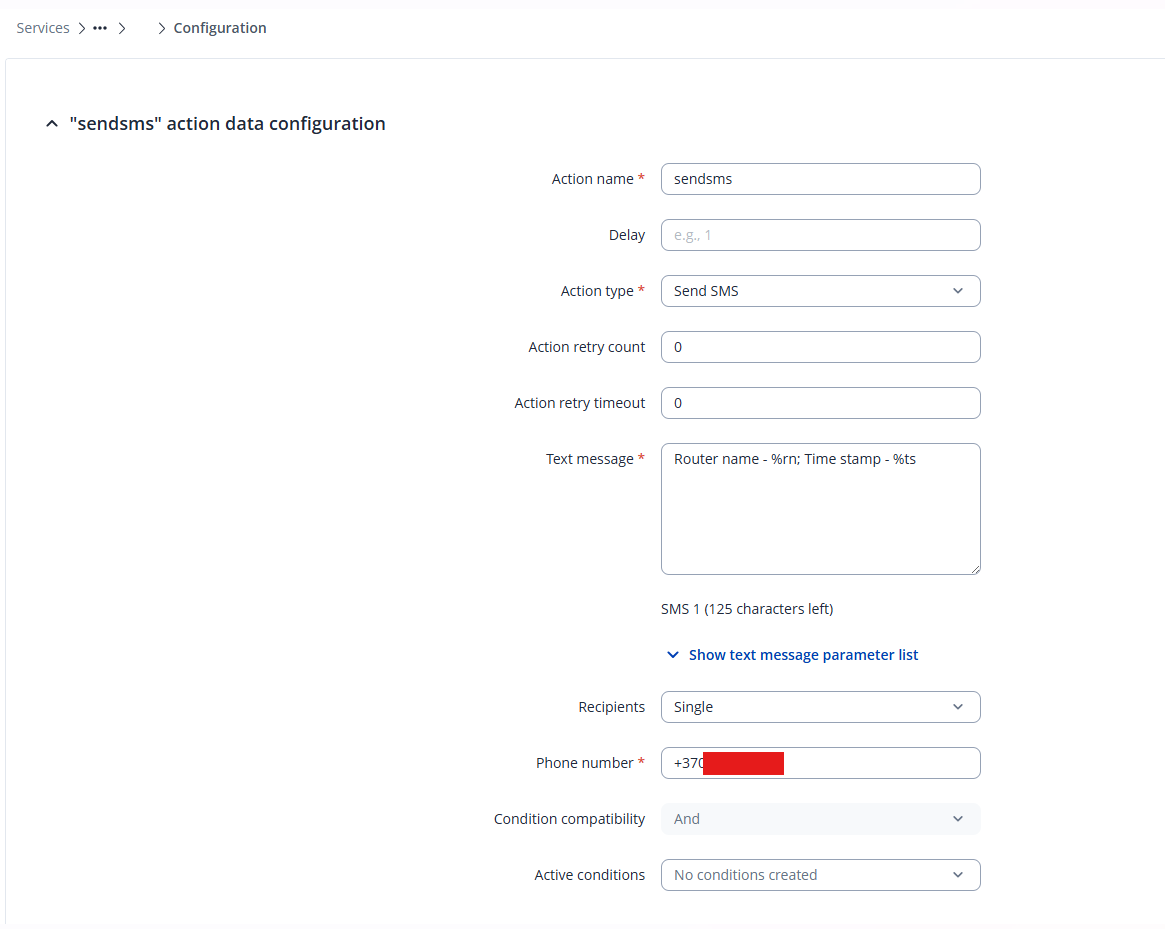

Click Next, then choose Send SMS as the Action Type. Enter the message text you want to send. You can also adjust additional settings such as retry count, retry timeout, and delay, if needed.
You can find more information about Event Juggler here: RUT360 Event Juggler - Teltonika Networks Wiki
