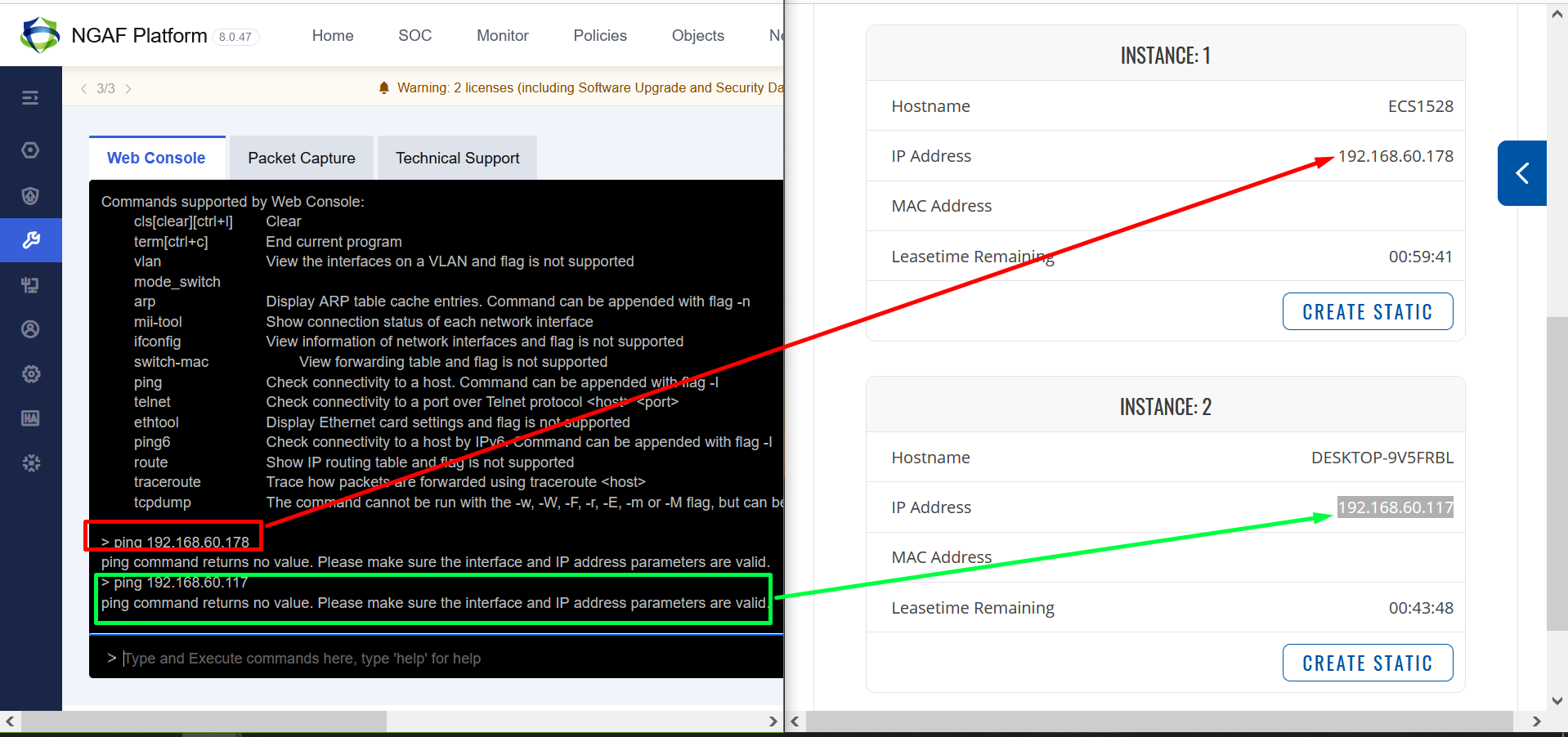

Right now my setup working can link sangfor ====> teltonika using IPsec VPN both. but i got issue for ping from Sangfor, i try ping ip address local inside teltonika from sangfor tool ping but sangfor “ping command returns no value. Please make sure the interface and IP address parameters are valid”.

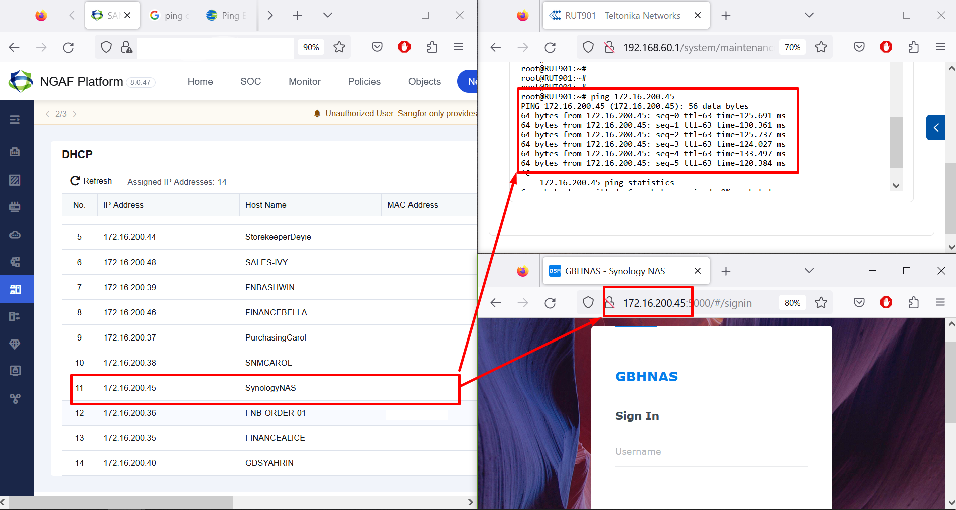

If i try ping using CLI teltonika ping ip address local at sangfor can ping + i try open that ip address using browser, i can access the NAS.
for this, teltonika got blocking the firewall rules? For RUT901 are using Sim card private IP as a main uplink & sangfor ngaf are using fix static ip address.
If from rut901 to sangfor can working & can access
