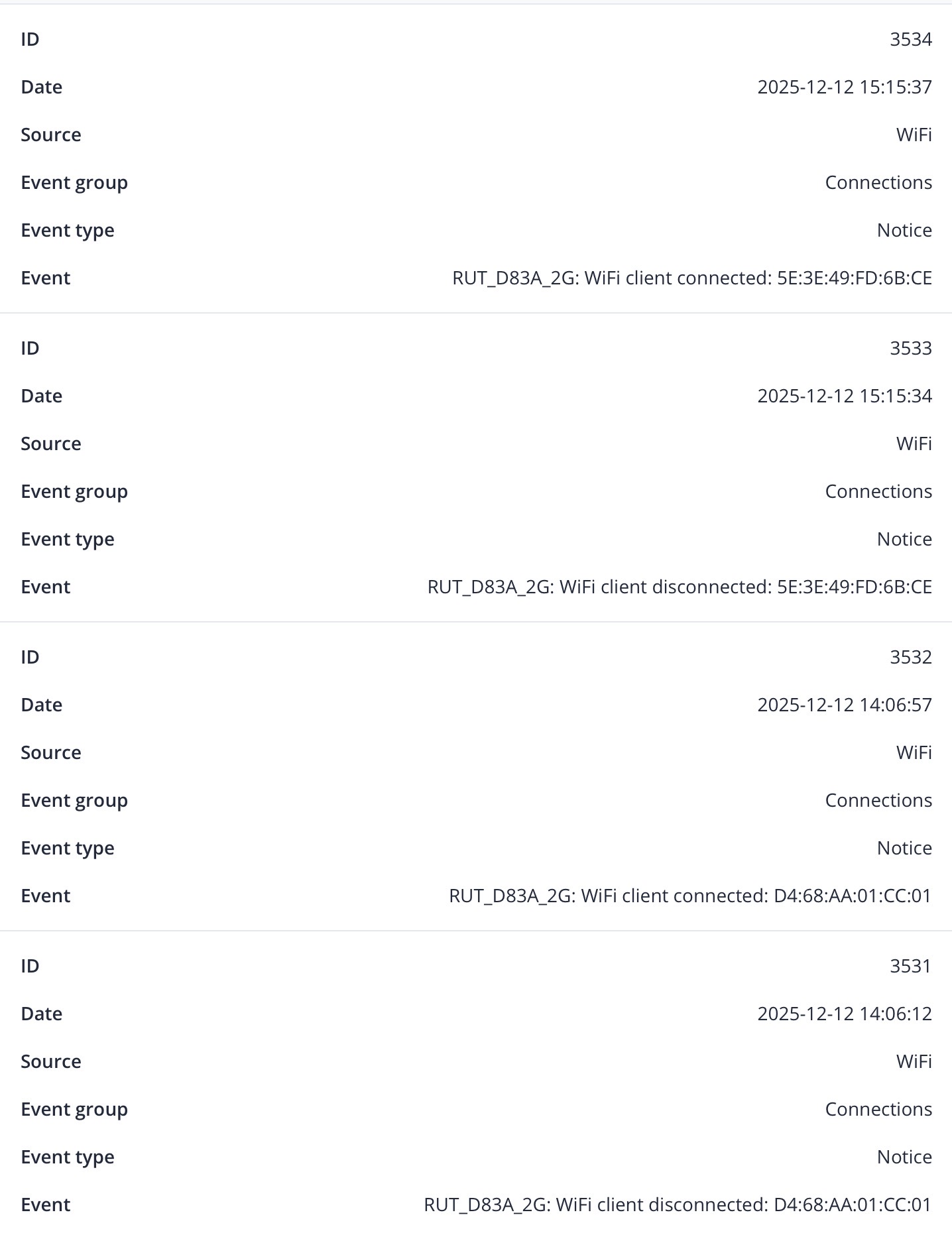

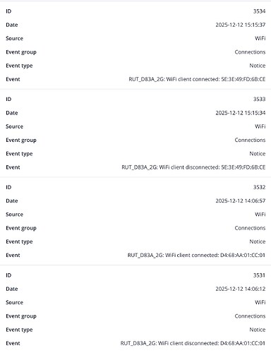

Have got the same issue with my router RUTX50.
I am on the latest available firmware 7.19.4
For my case it is solved, the password for my SSID_2G was changed to my login password!. This was not changed by me.
It was not change for SSID_5G
Could it be a bug in the latest firmware 7.19.4?
