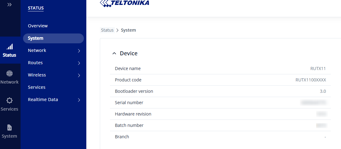

works perfectly in RUTX11

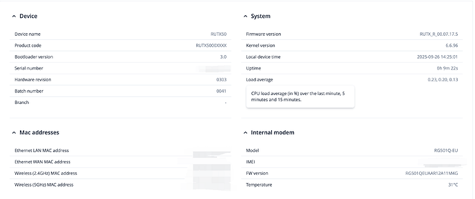

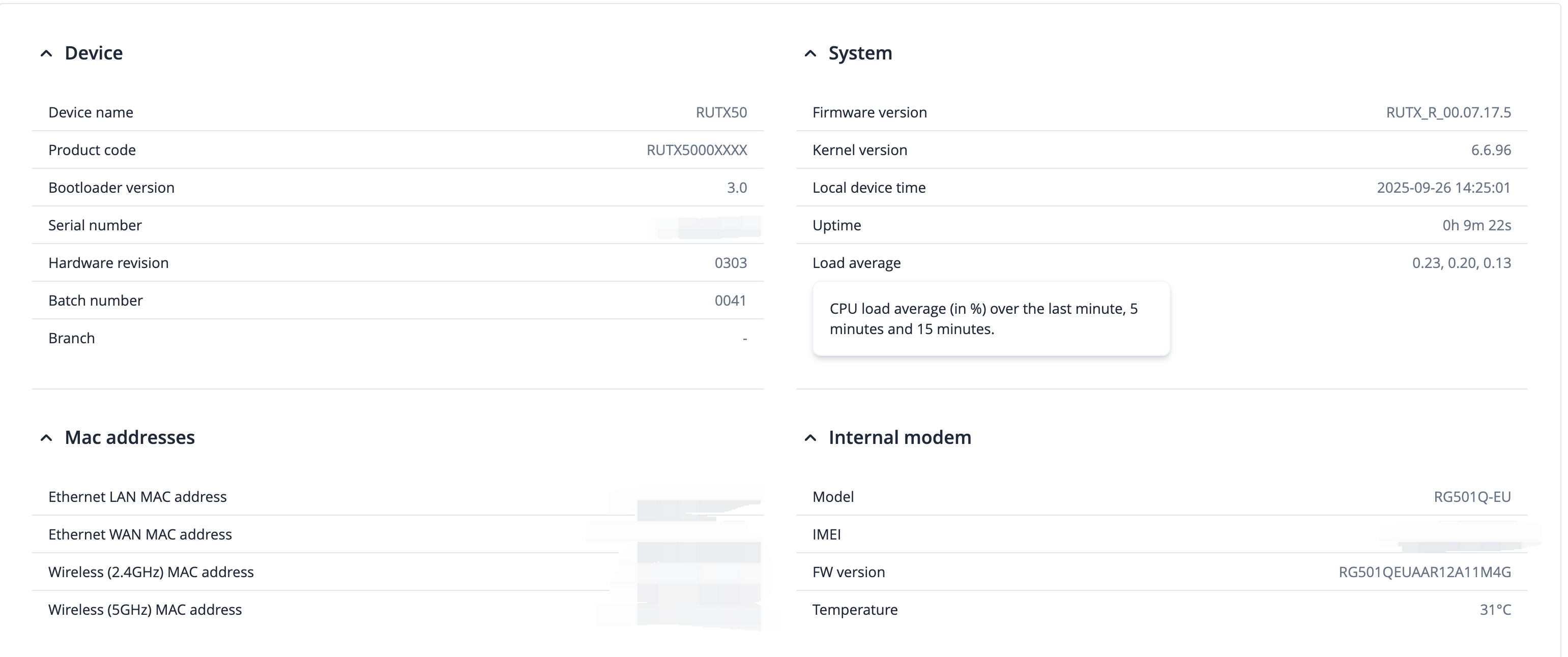

Could you please share the product code of the device? You can find it by navigating to Status → System , where it will be displayed under the Device section, as shown in the screenshot below.
This information will help me investigate the matter further.
Hi V,
Here’s the info. Please let me know if you need anything else, thanks.
Greetings, @usit2,
Thank you for your message.

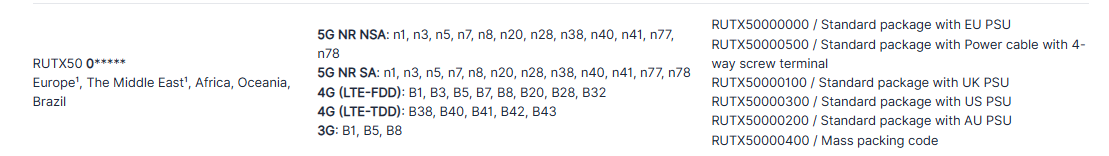

According to the screenshot you provided, it appears that the device is not intended for use in the United States region. As a result, the mobile module is unable to connect to the Verizon network.
For future deployments, please make sure to verify the available product codes on our website (in the ordering section) to ensure regional compatibility.
I hope this clarifies the situation.

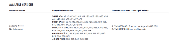

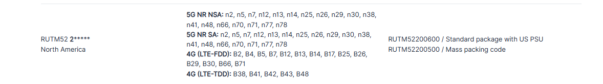

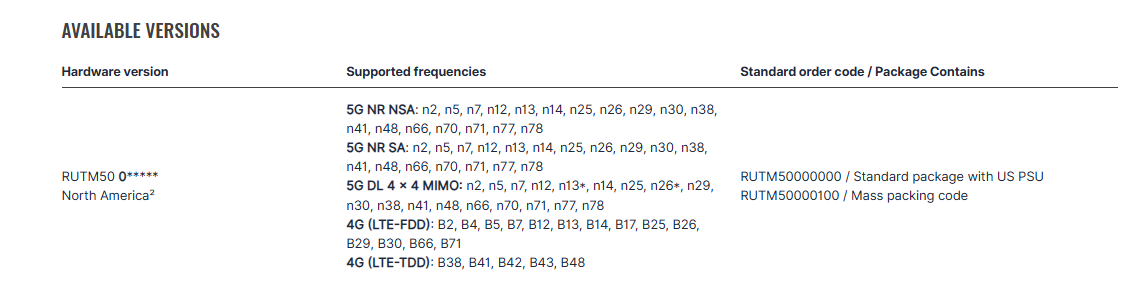

Based on your requirements, here are a couple of routers suitable for the US region:
When placing your order, please make sure to select the product codes shown in the screenshots to ensure regional compatibility.
