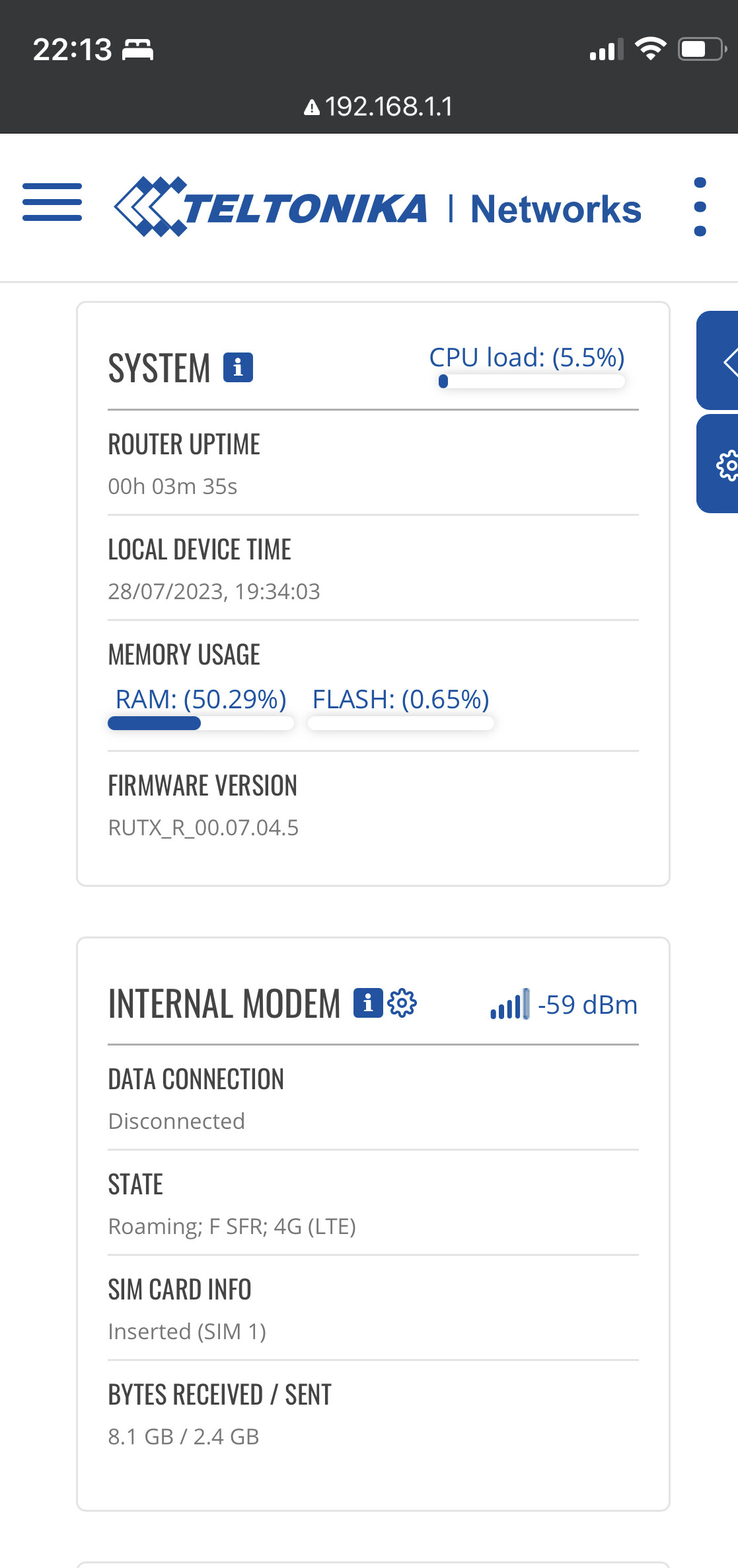

Update: still no Internet see picture… it’s a Vodafone sim and I’m using it within Europe.
Why is it failing at the data connection?
Even if I add an APN live.vodafone.com the data connection stays disconnected.
I switched SIMs with my phone: same issue…

Could you please share the signal parameters from System → Network → Mobile ?
What is the firmware version of the internal modem and the device itself? Those can be found in Status → System or System → Firmware .
Additionally, could you please navigate to System → Administration → Troubleshoot and view the system logs? Before sharing these logs here, please ensure you remove any sensitive data.
