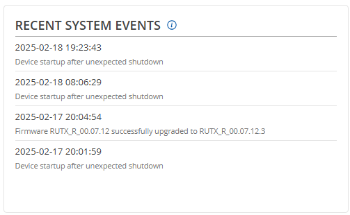

Latest “unexpected” hard reboots as per system log:
Yesterday evening had to reboot the device 3 times as lost the wired ethernet connectivity. Same this morning. Enabled the Wireless on the device yesterday to debug if all connectivity is lost with that I could access the GUI and internet after the wired connection fails. Looks like the wired LAN just stops responding/working. Could not see anything in the device logs.
Is there any processes/services that could be checked when the failure happens?
