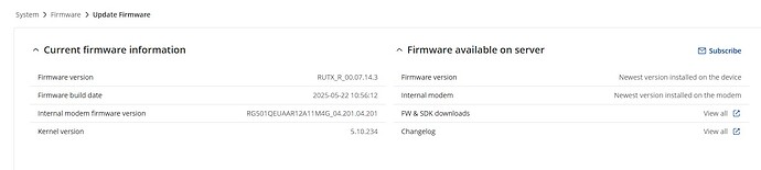

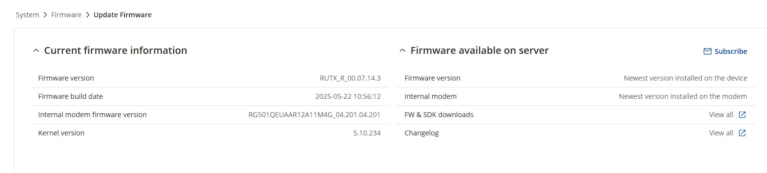

All the latest updates F/W plus Modem update done.

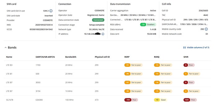

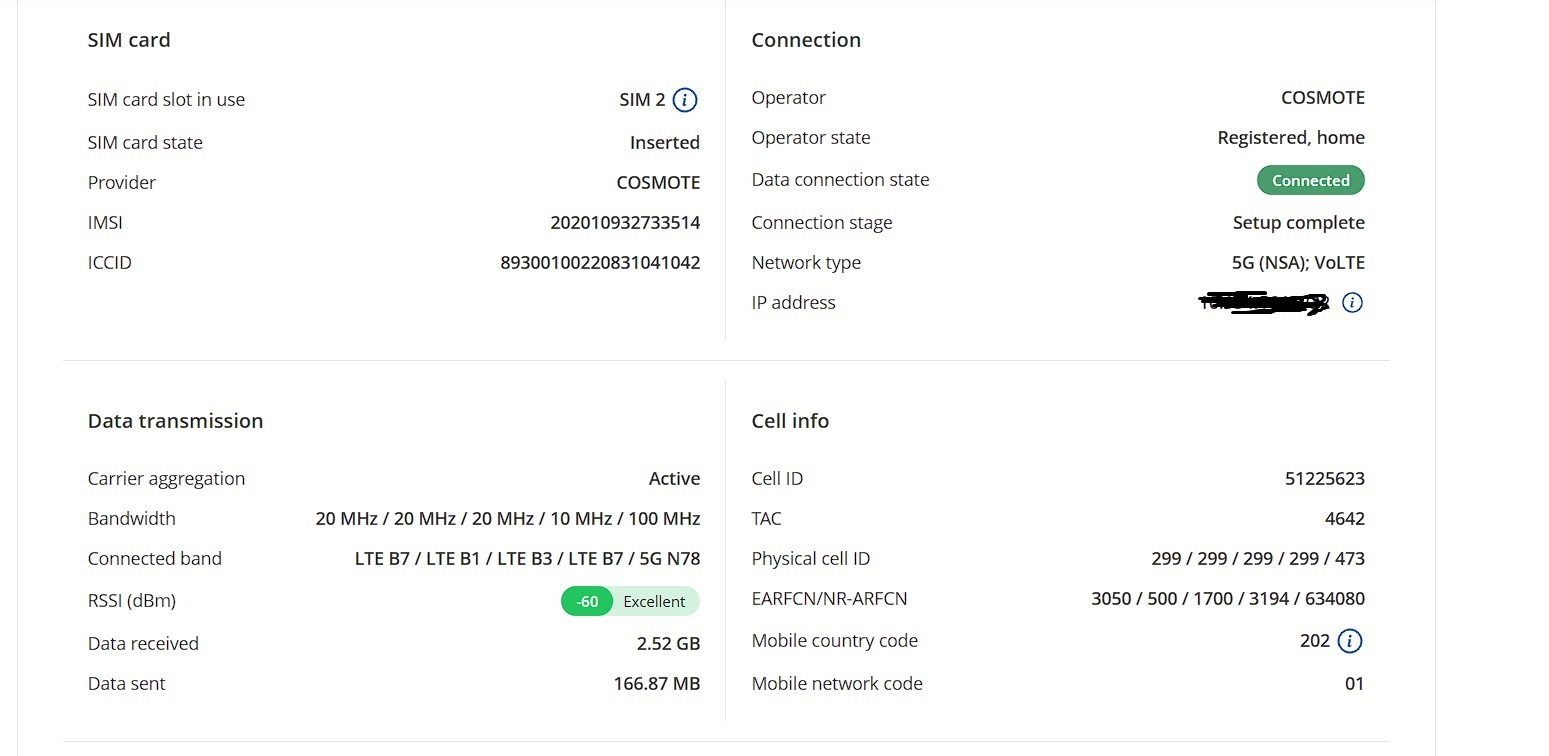

Updated info bellow:
Almost everytime running speedtest the connection drops.

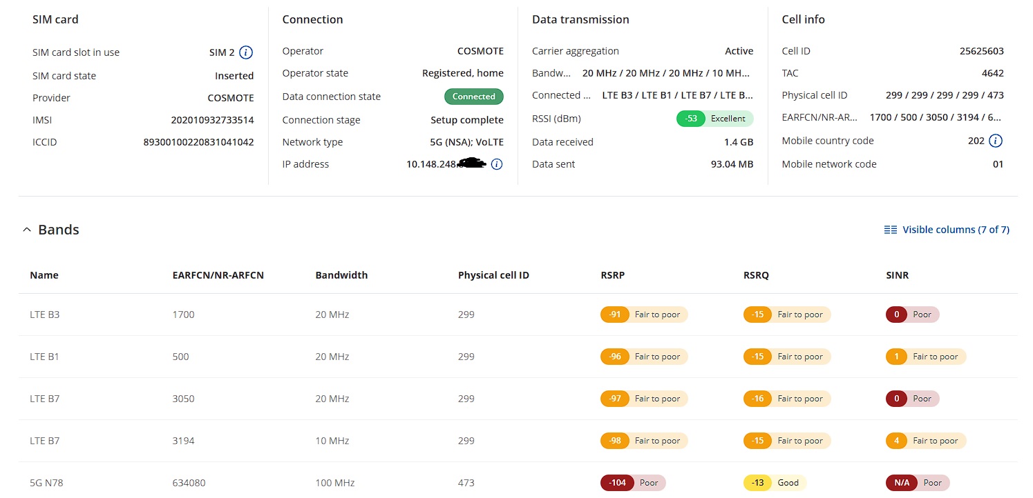

From the screenshot you provided, it appears that your device has a very poor mobile signal, which is most likely the cause of the disconnections. You can find mobile signal strength recommendations here: Mobile Signal Strength Recommendations - Teltonika Networks Wiki
Please confirm whether the original mobile antennas are properly connected to the device at a 90-degree angle. If they are and the issue persists, I recommend moving the device closer to a mobile tower or testing it in a different location to see if signal quality improves.
If better signal strength resolves the issue, you may want to consider using higher-gain antennas for a more permanent solution. However, if mobile disconnections continue even with good signal, let me know and we will proceed with further troubleshooting.
Good evening Marija, thank you for your reply,
I agree about the streght of the signal and I was already playing with build in antenna azimuths.
The device was bought for mobile use in a yacht,
we were using in the past the 4G version of your products but we had the shame issues.
Finally we had to buy another product from alternative manufacture 3 years ago and it was fine so far,
we have two semi omni outdoor antennas installed at the same place 5 years now without issues, (already antennas tested with network analyzer about connectivity, possible gain loss and Z too)
I just mention before the compare between the phone and router, it is not right about the signal strengh i mean because with a low cost mobile phone at the same place my signal is really better than the router’s signal without playing around with angles and high.
I can do a few tests more and I’m gonna return with new data.
