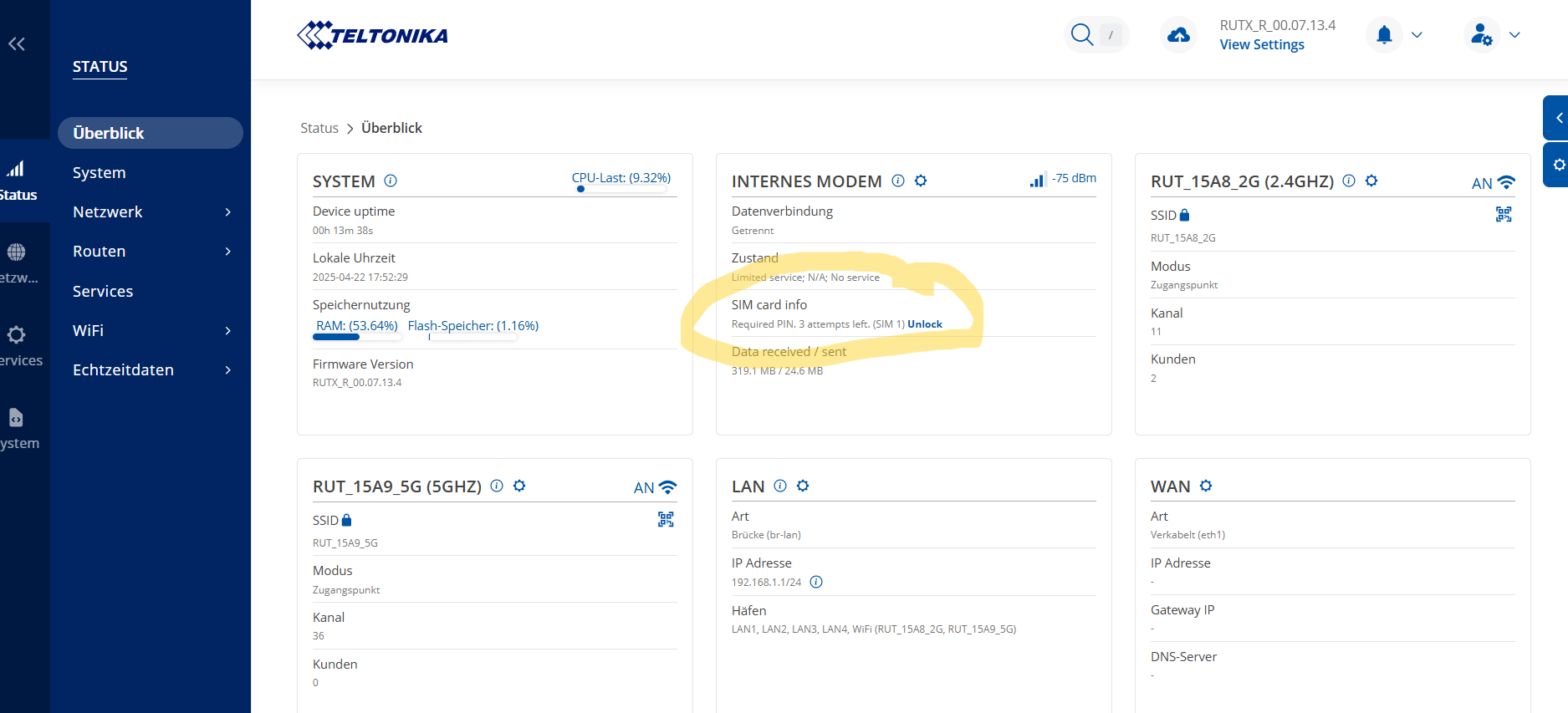

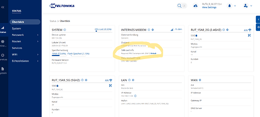

I have a problem with mobile connection. As soon as I start a speed test via the laptop connected to the LAN port, the mobile radio connection is disconnected. Below are the last entries from the logfile:

What is striking, the SIM PIN is saved and yet the SIM is displayed as locked.
Good afternoon,
Seems like the device is either not registering the Pin code, or it is incorrect.
Please reset the device via bootloader method : https://wiki.teltonika-networks.com/view/RUTX50_Device_Recovery_Options#Bootloader_menu
Firmware : https://wiki.teltonika-networks.com/view/RUTX50_Firmware_Downloads
After that, please in WEBUI Network → Mobile → General input the Pin code, and don’t forget to press save and apply.
Lastly, try a different Sim in this device, and this Sim in another device and see if it operates differently.
Arturas
After a while unlock is no longer displayed and it has automatically unlocked again. So he can’t forget the PIN.
