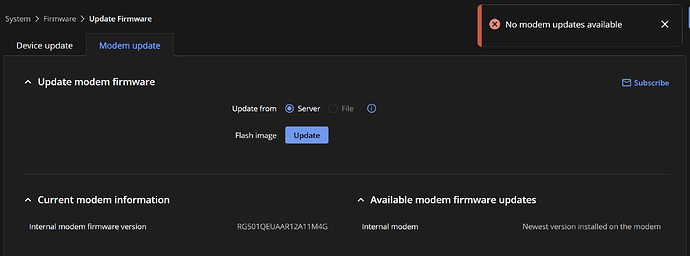

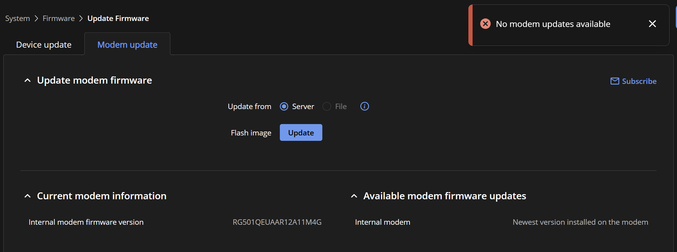

Any idea how to solve that?
What is the modem firmware currently?
Modem Firmware is: RG501QEUAAR12A11M4G (ui says latest)
Device Firmware is: RUTX_R_00.07.23.1 (but we had it also with the latest stable version, just upgradet to latest because of this issue)

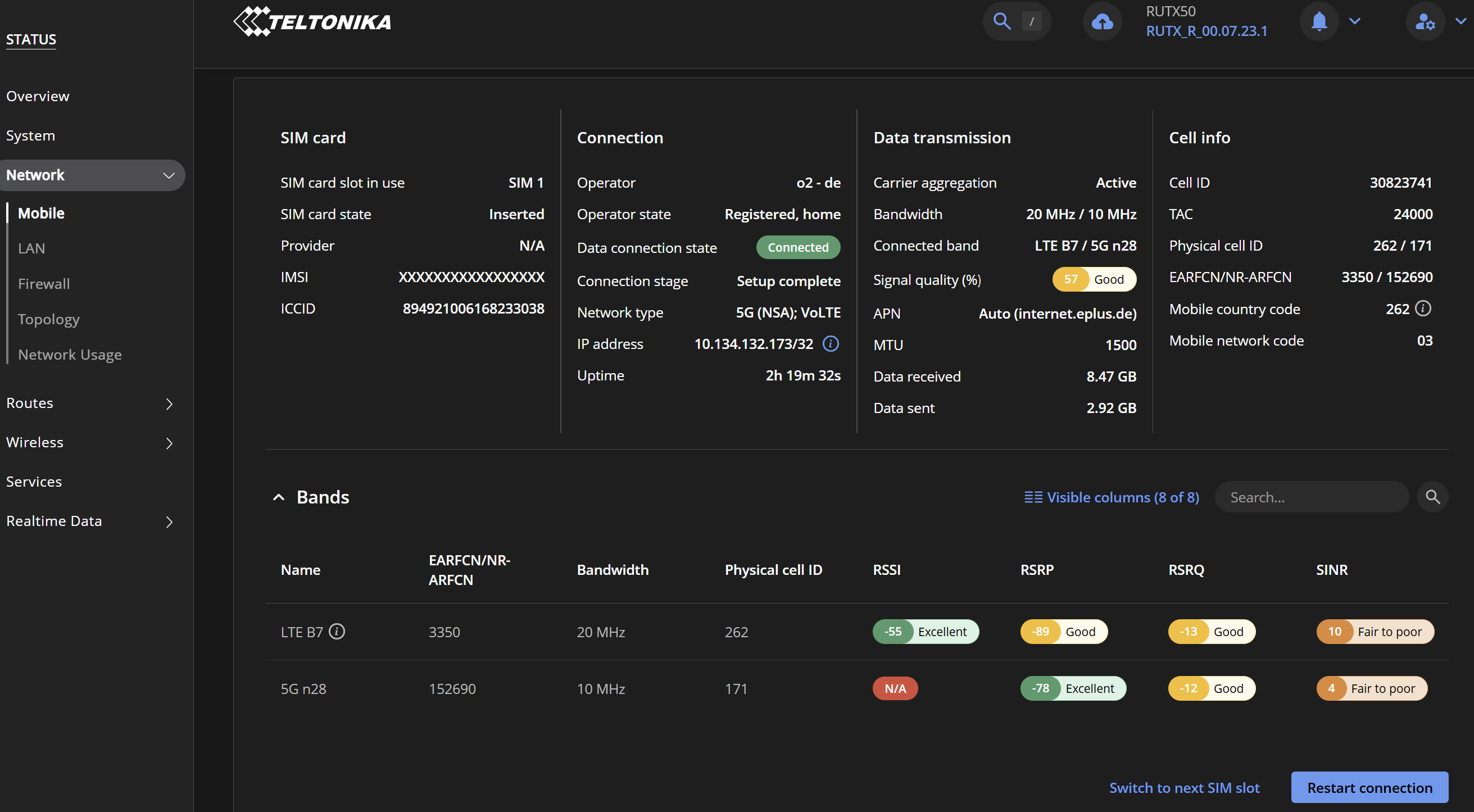

Can you provide a screenshot of Status > Network > Mobile masking out your IMSI number.
Sure. You need an additional one from this page in state the connection is lost?

If your device has the RG520N modem …
If you login to the UI, under the ‘Firmware’ menu, you will see that there is a new MODEM firmware update issued yesterday.
It will install version RG520NEBDCR03A06M4G_A0.300.A0.300
Apply this to see if it resolves your issue.
At the moment there is no Firmware Update available for the Modem
That’s because you don’t have the RG520N modem in your RUTX50, you have a RG501Q series. As per my opening words … “If your device has the RG520N modem” … so my advice doesn’t apply in your case.
The modem firmware version you are on is the the latest version for your modem, and pretty much rock solid.
Looking at your screenshot my thoughts are that although band LTE B7 isn’t the best of channels to get you have a decent signal at 20Mhz. But your 5G n28 band is very poor at 10Mhz.
Can you move the RUT to a different position to get a better signal and or buy a good exterior antenna and put it somewhere were it can get a strong signal from the mast you are connected to?
This is a good call … give it a try.
In some of our locations where the 5G signal is poor or fades in and out, we have to set the connection to 4G only, to give us a stable connection.
Problem is independent from the signal strength. we have switch our position (rutx50 is in a sailboat) every 2 - 3 days. also with very strong connection we have the problem of this disconnection.

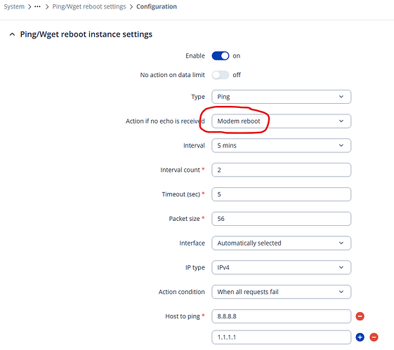

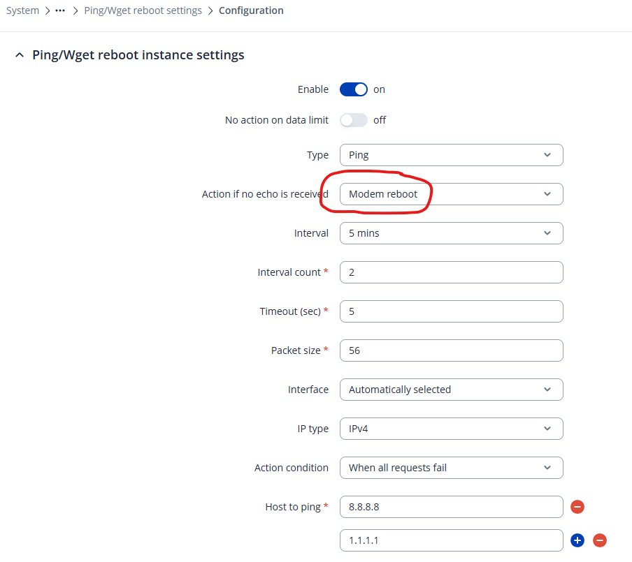

Try anabling the Ping/Wget reboot option by navigating to SYSTEM > MAINTENANCE > AUTO REBOOT > PING/WGET REBOOT
Note that the ‘Action’ is set to ‘Modem Reboot’ and NOT the default ‘Device Reboot’.
This MIGHT work with just the ‘Restart mobile connection’ set as the action (in theory the recovery time will be quicker), but the ‘Modem Reboot’ is a bit more of a catch all.
RUTX is on the Top of the Hull in the Window. Connection is really good from there the most time (we have download rates > 150 Mbit / s). Problem appears also when we use the connection. I’m working from the boat for 8 hours per day, in this time we have 2 - 8 disconnects. i can directly reconnect with the button on the status mobile page. with restart connection i have back the connection in seconds. but problem is in case of a call the call ist disconnected, thats bad for remote working.
hmm good work around for the moment. i can setup the interval to minimum (1 min). but in case of running phone calls also 1 minute ist to much time. at the moment i work with open tab in the status mobile page, so i can directly press the button.
