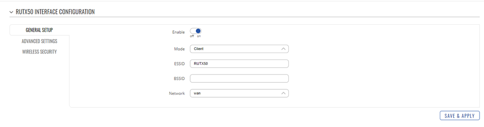

In case the SSID is hidden, you can still manually connect to it. What you need to do is to press ADD button which is located on Network > Wireless. In pop-up window you will need to choose :
- Mode : Client;
- BSSID – client access point identifier/name;
- Network : wan.
