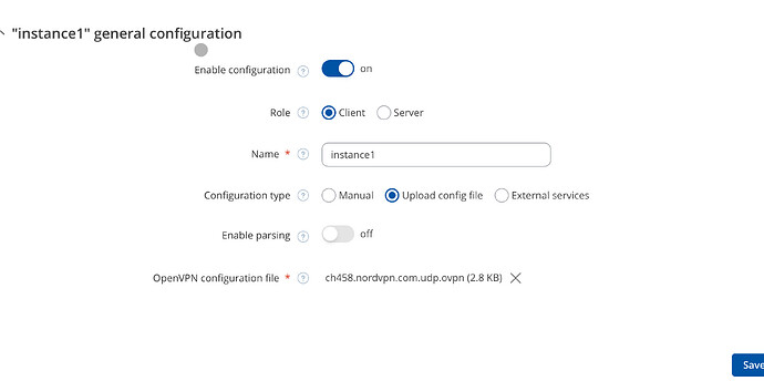

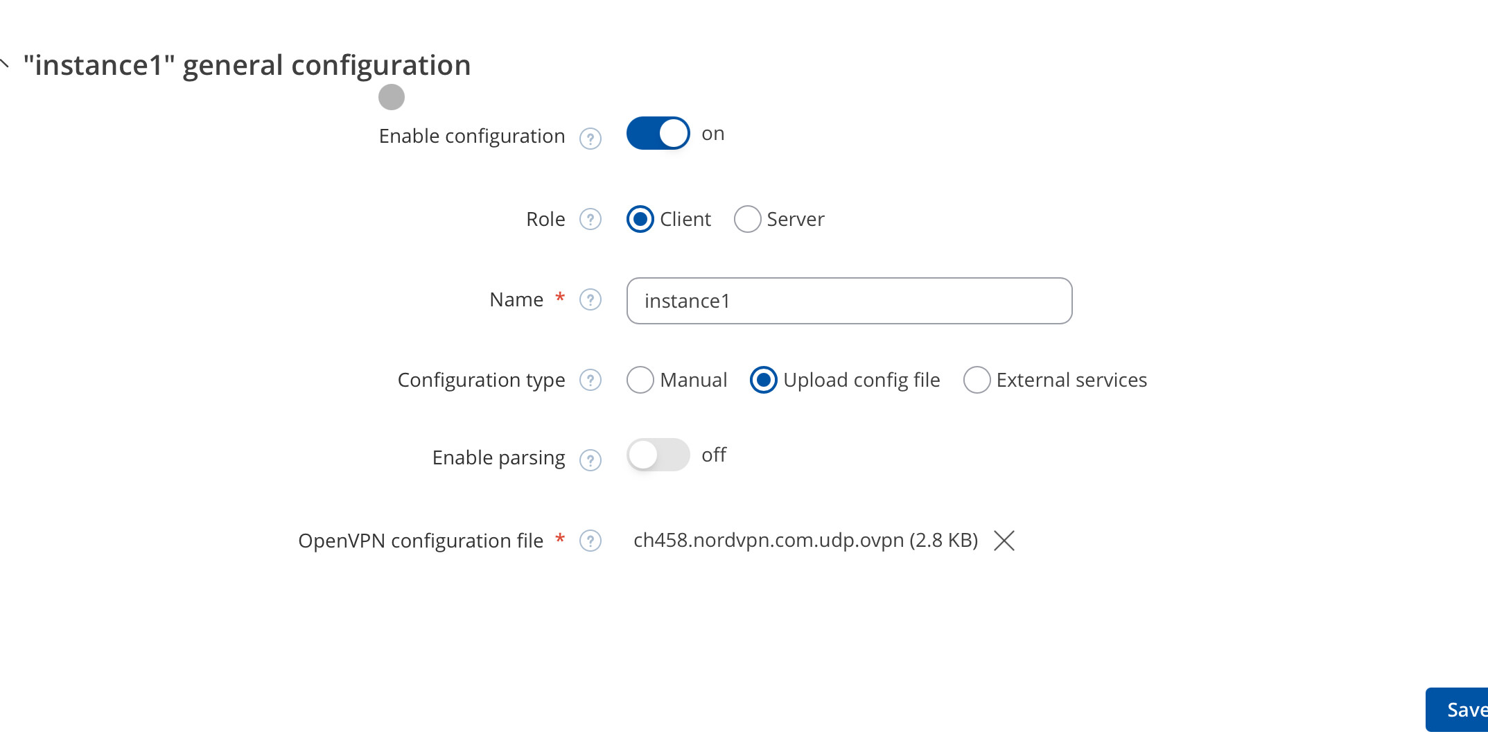

Now the VPN channel with openVPN & NordVPN can not be configured correctly.
When I configure the configuration file, there is no possibility to define user&password.
When I configure the external service there is a possibility to place the user&password from NordVPN.
But I do not get a a VPN link to my defined country ….
What do I wrong.
Thanks and regards
Peter
Try Enabling Parsing … does that then display whay you are looking for?
If not, also set ‘Configuration Type’ to manual.
Hopefully this will give you that, which you seek.
yes it works now - many thanks
