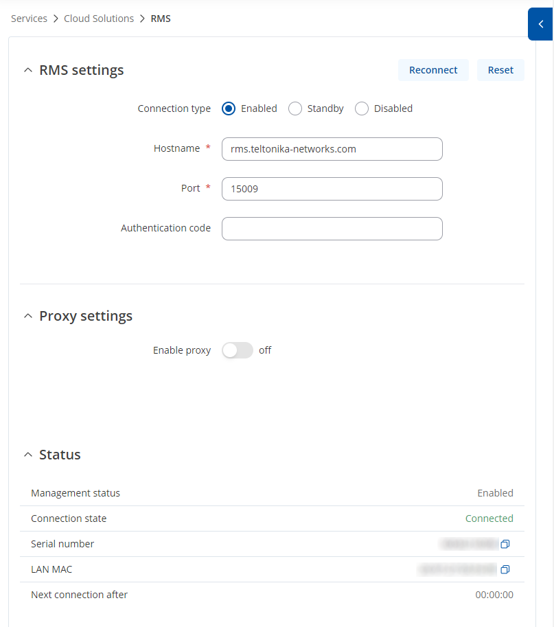

On the router WebUI (Services, Cloud solutions, RMS), Connection type is Enabled and Connection state is Connected.

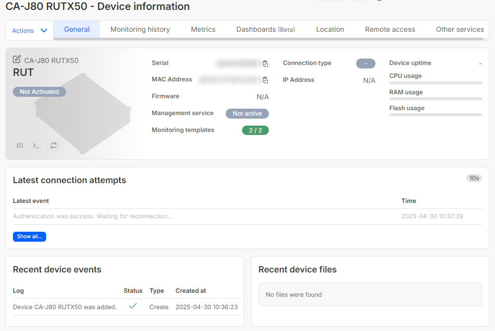

In RMS console, I can see the device but it shows Not activated and Management service is Not active. Connection card show that authentication was success.
Device services are enabled.
There is no Authentication code information in RMS, so I did not enter it in device web UI.

I have powered on the router this morning and now it appears as enabled in RMS console, and I have been able to setup VPN. I did not change any setting on the RUTX50. Problem seems related to RMS platform.
