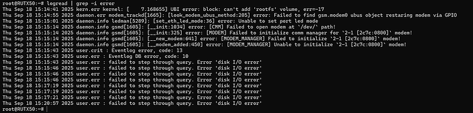

Additional information after further investigation:
I have investigated the filesystem and logs on the router, using support from ChatGPT, and found some potential issues:
  • The df -h output shows partitions are not full and mounted read-write as expected, so lack of space should not be the problem.
  • However, logread and dmesg show UBI errors like block: can't add 'rootfs' volume, err=-17 indicating problems with the NAND flash or root filesystem volumes.
  • There are repeated errors in system logs saying “failed to step through query” and “unable to open database file”, which strongly suggests filesystem corruption or flash wear issues.
These errors could according to ChatGPT explain why the firmware upgrade process completes without error but does not actually flash the new version. The internal flash or rootfs volume might be damaged or locked in a way that prevents modification.
At this stage, ChatGPT suspects that the problem is not with the upgrade method itself or firmware files, but a lower-level flash memory or filesystem issue.
Has anyone else experienced this UBI rootfs volume error on a RUTX50 and managed to resolve it? Could this be fixed by a deep factory reset, a special repair tool, or is this a hardware failure requiring RMA?
