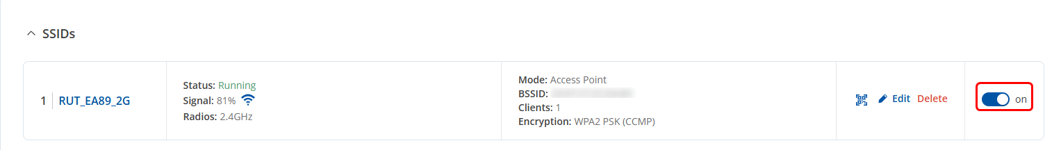

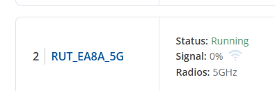

As lemondude asked, are all Wi-Fi antennas attached to the device? Additionally, what’s the status of the Wi-Fi interface in the WebUI? Should be up and running as seen below:
Hi, yes WiFi Antennas attached and I switch it also a cross. No changes.
Hi, the status is exactly the picture you sent.
But antennas signal is 0%.
Best regards
Claus

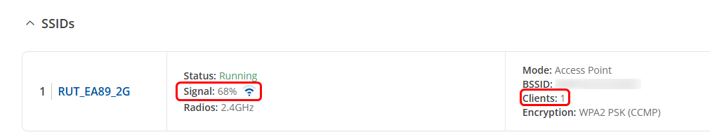

The signal is going to be 0% until a client connects, I believe. Here you can see a signal appeared for me once I connected:

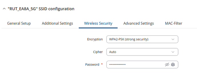

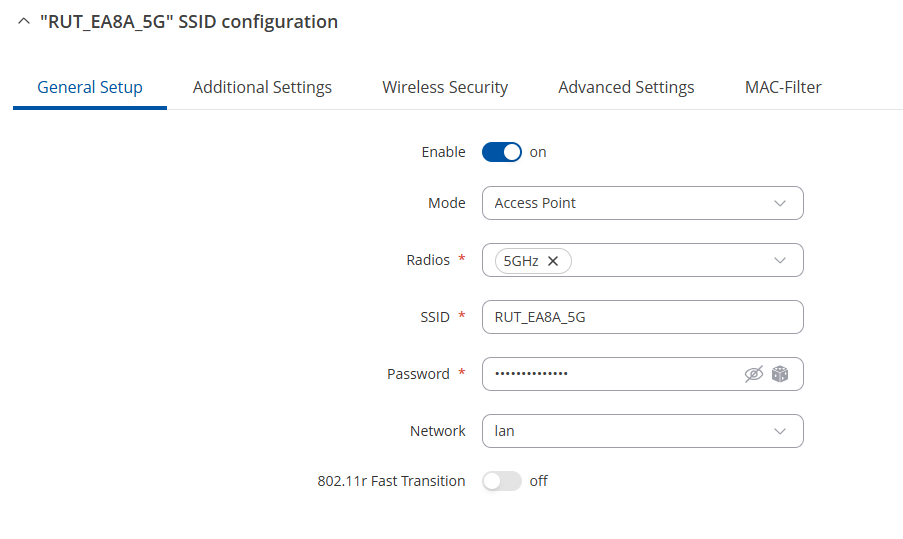

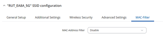

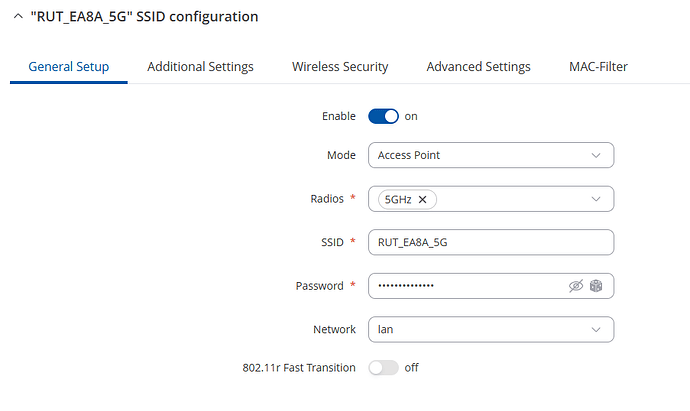

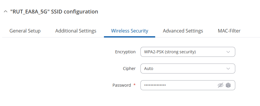

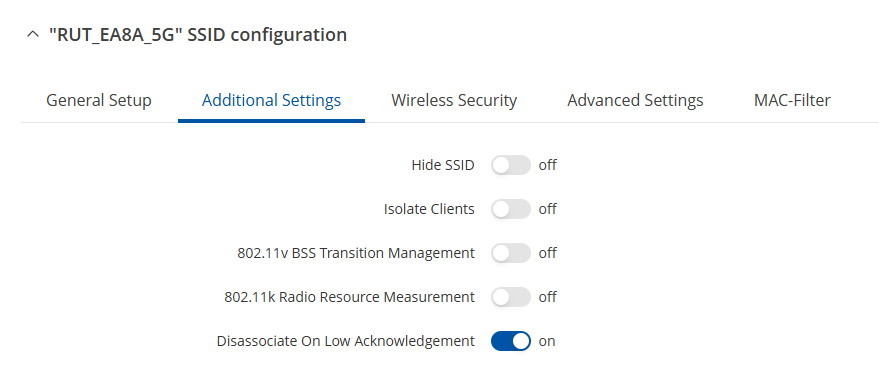

  1. Deleting the 5GHz interface and recreating it from scratch, options are as follows (I use a RUTX11 for these photos):
(Advanced settings tab can be leaved untouched).
