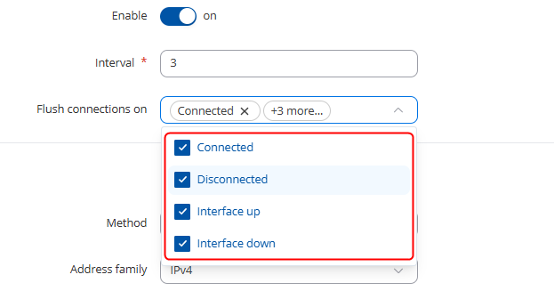

Hello Hendrik,
Thank you for the screenshot. Could you check and confirm if the Flush connections on option is enabled on the mob1s2a1 and wan interfaces as well?
Looking forward to hearing from you back.
Hi Martynas,
no, that was not enabled on any interface (per default). I enabled it on both Interfaces. I will check later if that works.
Kind regards
Hendrik
That didn’t work. It even got worse that the mob1s2a1 connection wasn’t working anymore even if I unplugged the WAN port.
