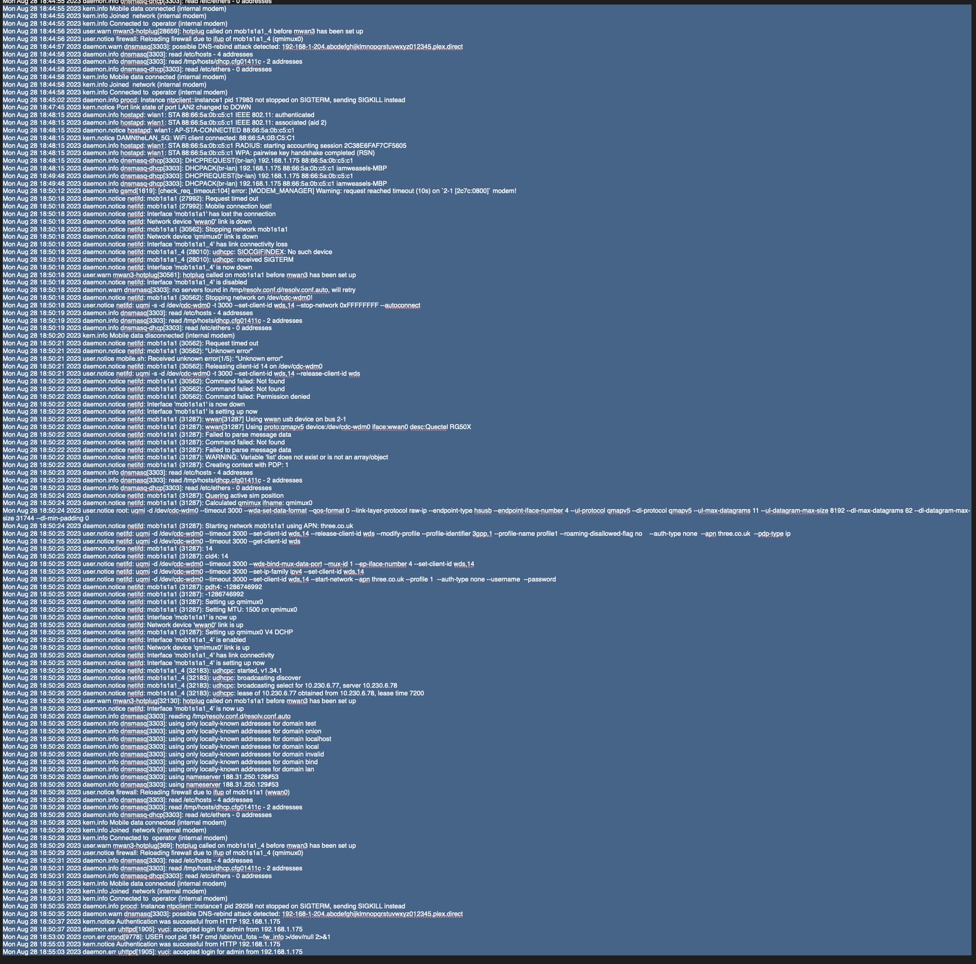

I can confirm the firmware is up to date… and I will get those logs for you shortly :slight_smile:
Screenshots:
It seems like for some reason the modem stops responding and then after some time re-establishes the connection. This could either be a software, or hardware issue. To dive deeper into the issue, we would need a private communications channel, thus I’ll ask you to contact your sales manager, reseller, or fill out the Contact Us form here: Teltonika Networks - LTE Routers, Gateways & Modems for IoT
