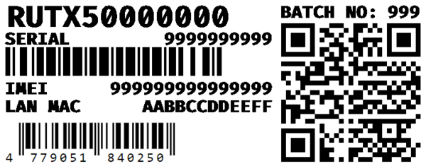

Where do I find the mac address on a RUTX50 please?

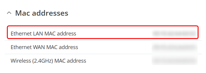

LAN MAC is available on device body, for other MAC addresses login to WebUI and go to Status→System page.
The LAN MAC address can be found on the label of the device, if you currently have physical access:
If you do not have physical access, you may login to the WebUI of the device, and head to Status → System:
