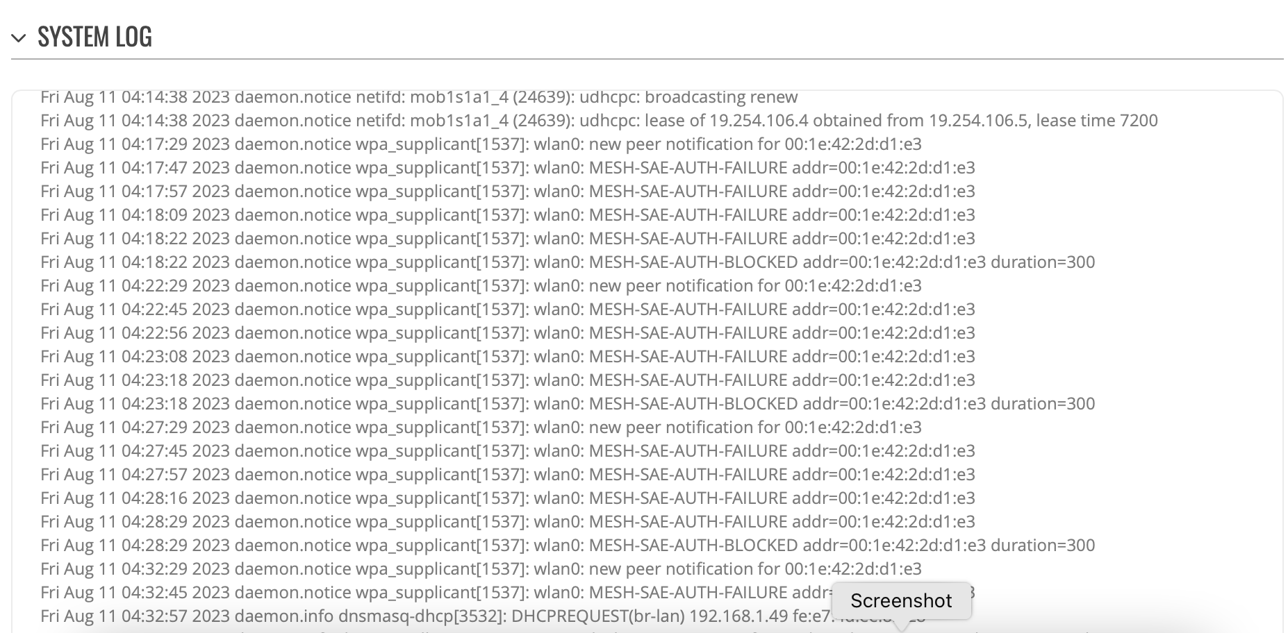

Hi, I have a Rutx50 and 2 x Rutx10. One rutx10 is switched off as we issues with some connection drop outs stating no internet while other devices could connect and wanted to eliminate the unit but I have not switched it back on. However when following up another topic I discovered the logs and notices a recurrent issue with the Mesh network. I have set this up via your guide and you can see the mesh nodes are connected as clients in the mesh network but I noticed these message in the logs:

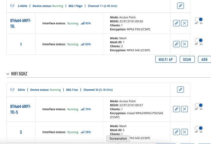

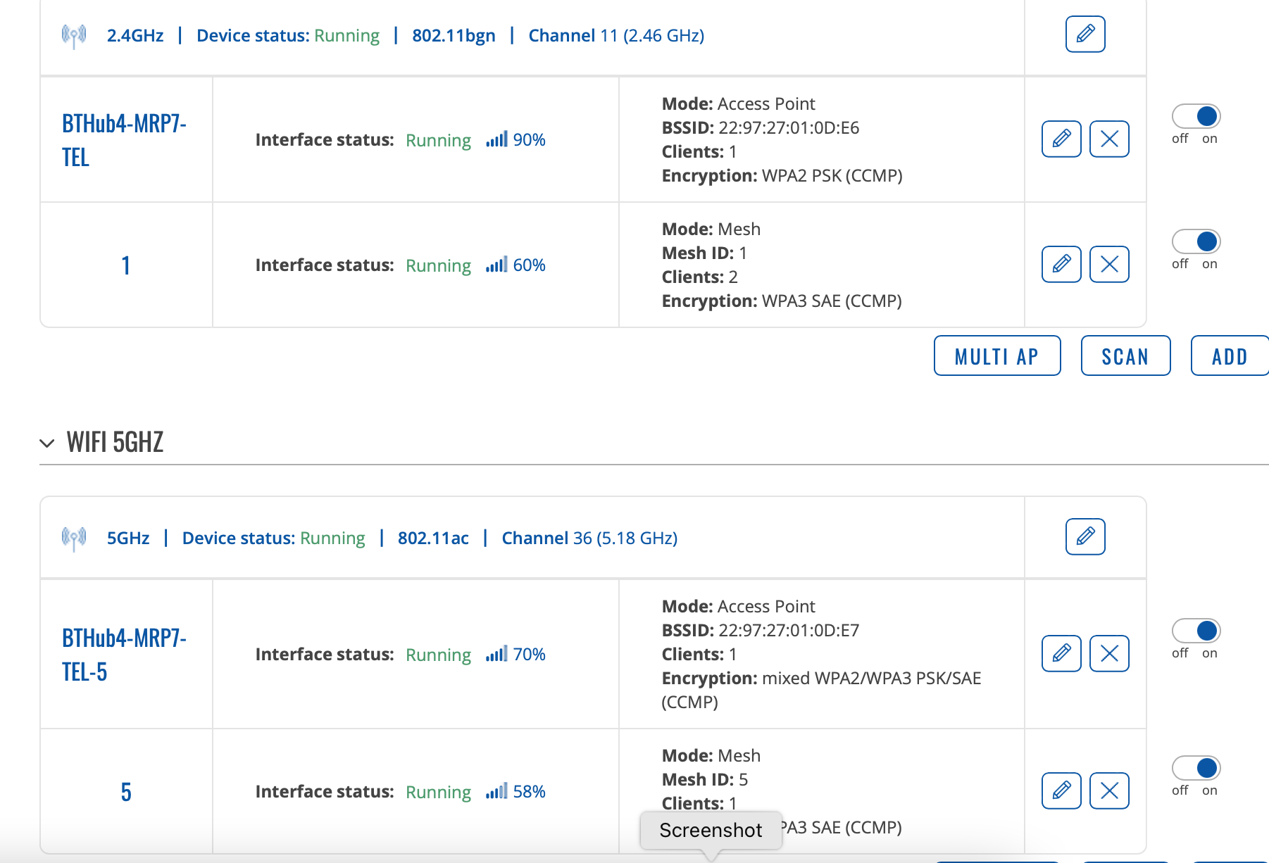

Hi, I have just switched on the second rutx10 - so there are two mesh nodes. Interestingly this only shows in the 2.4 and not the 5 ghz. The channels are locked on all mesh devices so settings are the same - I can see the IP addresses of both rutx10 nodes when logged into the rutx50. Here is the network page:

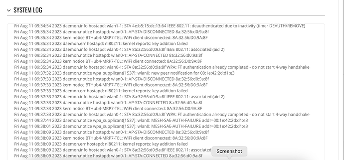

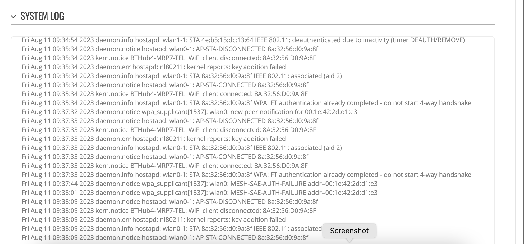

And these are the messages after I switched the 2nd node on and the network slowed down so just switched it back off:
