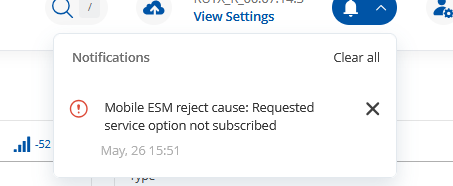

Just to update you, this is a message I can see now.
not sure if this is relevant

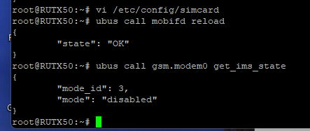

In the first instance, if you could go to WEBUI Network → Mobile → Connection, and disable VoLTE.
If you could then login via SSH, and please try to edit the /etc/config/simcard file and add to the SIM1 section in simcard: option disable_ims '1'
You can edit the file using the editor as ‘vi’ (vi /etc/config/simcard). In the vi editor, press “INSERT” to start editing, “ESC” to quit the editing mode, “:wq!” to quit the vi editor and save.
Example :
After editing the file, reload mobifd with the following command
ubus call mobifd reload
Check IMS state again.
ubus call gsm.modem0 get_ims_state
If you can confirm that it is disabled, retest the mobile connection.
Arturas

I have done what you suggest, this is the screenshot
Allow me some time for testing, usually it was failing very quickly, I’ll keep you posted.

Hi Arturas,
looks like the problem has been solved, so far no disconnections, for what I can see it works fine. In the next few days I will put back the previous settings via the UI.
Will let you know if I see any other issue. I will update you anyway, so you can close the call if is all ok.
