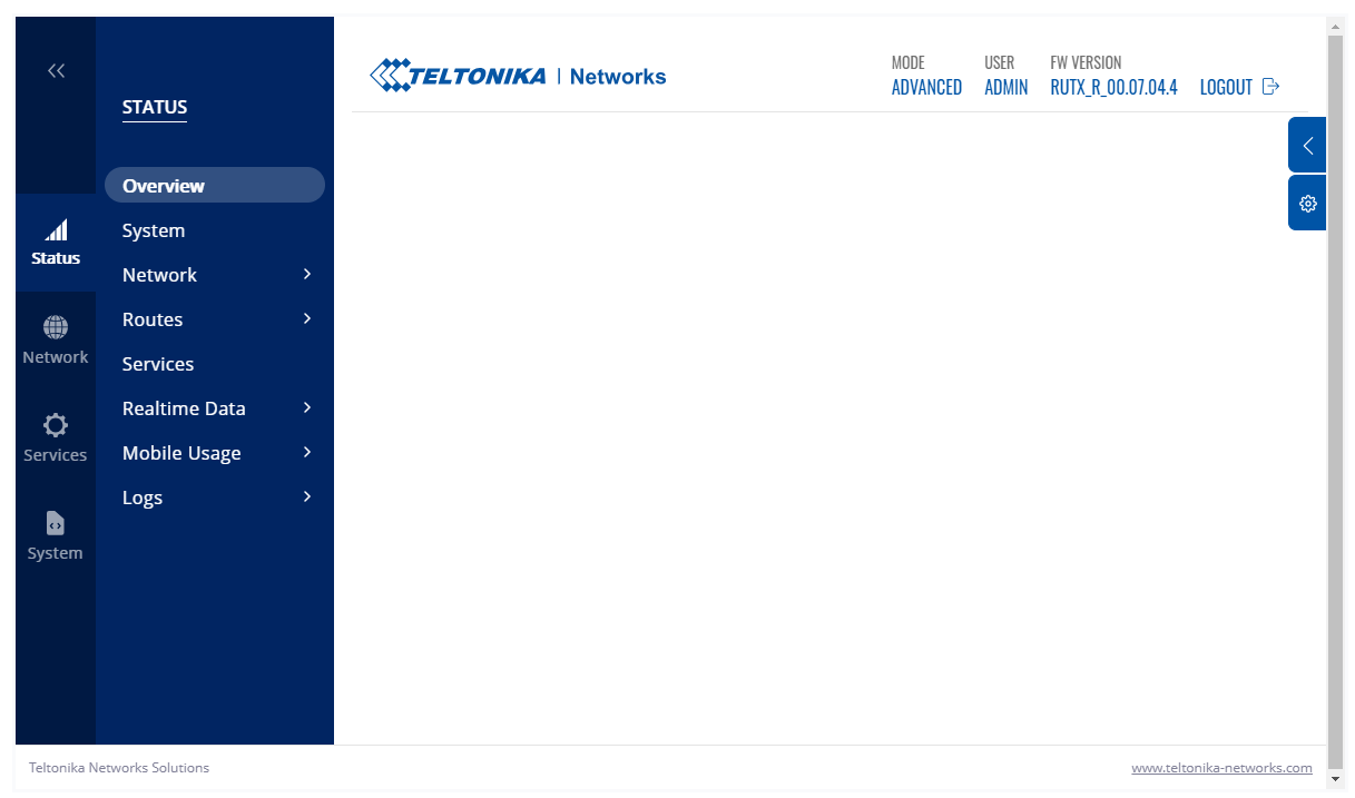

I was just reading about the option of rebooting or restarting the modem connection. So I wanted to try. Normally I go via overview to the modem and restart. But in this state it seems that the overview screen is not avaliable. Empty… I had that before as well and perhaps related to the same state of the router. There are some firmware issues I would say that are really troublesome/unstable.
