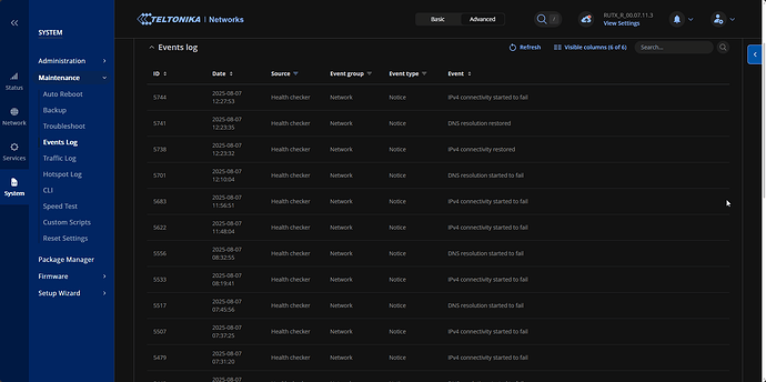

We are currently experiencing recurring network issues with our Teltonika RUTX50 router that have become increasingly disruptive to our operations.

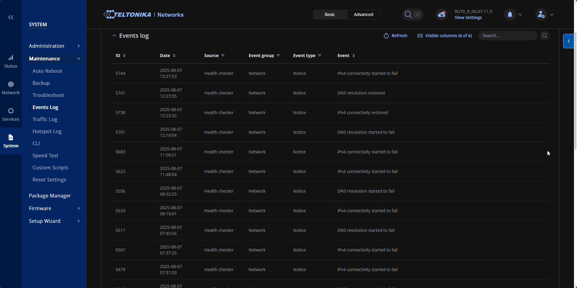

For the past month, we’ve observed that approximately every 10 minutes, the following events are logged:
  • “IPv4 connectivity started to fail”
  • “DNS resolution started to fail”
During these periods, we are unable to access any online resources or even communicate with devices within the same intranet. Ping tests to other devices connected to the same RUTX50 also fail, indicating a complete loss of local and external connectivity.
This router had been functioning reliably for about six months prior to these issues. Initially, the problem occurred once every 2–3 days, but it has since escalated to happening every few hours. Our current temporary workaround is to restart the RUTX50, after which connectivity is restored within 3–4 minutes. However, this is not a sustainable solution.

As a first step, please upgrade your device to the latest 7.16.3 firmware version. It can be downloaded from the following link: RUTX50 Firmware Downloads - Teltonika Networks Wiki
If the issue persists after updating the firmware, please check if the mobile antennas are properly connected to the router.
You can also check the signal strength and any errors related to the mobile connection by navigating to Status → Network → Mobile in the WebUI. Recommended signal strength values can be found here: Mobile Signal Strength Recommendations - Teltonika Networks Wiki
For a more in-depth investigation, you can check detailed logs from the device in System → Maintenance → Troubleshoot.
Please let me know how it goes and if you need any further assistance.
