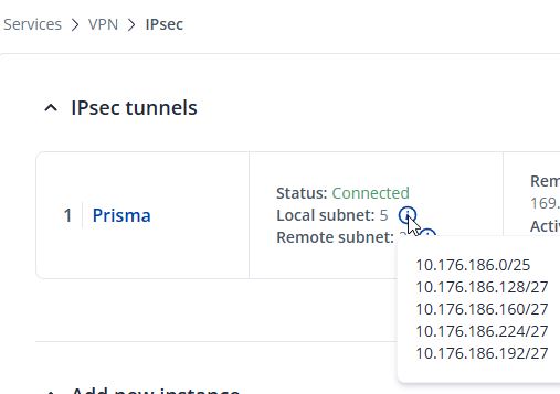

first screen… you have some networks… /25 and /27
second screen… you have a super net /8 overlapping everything!
also… overlapping /10
