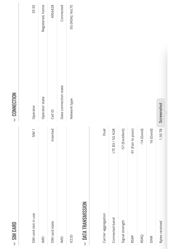

Hi, the physical location has not moved and it is connected to a Poynting 5G-XPOL-1-V2-21 external antenna on outputs 2 and 3, I tried 1 and 4 following another forum post but it made no difference. The antenna sits on the outside of the house and is angled to get the best signal. The other two outputs have the antennas that arrived with the Rutx50 connected. There was an issue with 5G which the carrier acknowledged and was then confirmed as fixed so I am getting a bit more 5G where as before there was nothing but its not at the same speed. I have attached the screenshots - looks like its restricted to 1 / post:

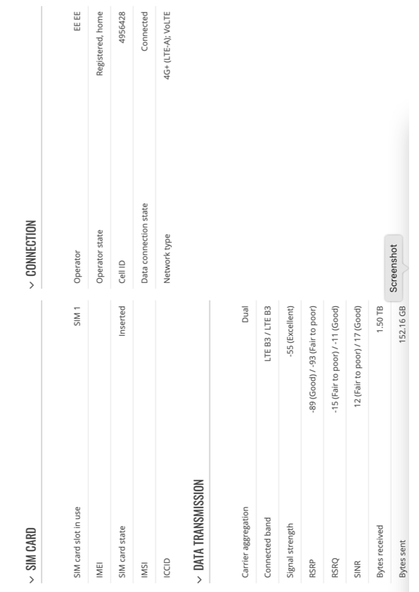

And the 4G version - I removed the 3 fields for the sim card but they are all populated.
Thank you for the provided information.
Since your carrier is utilizing 5G Non-Standalone network, it can be tricky to force the modem to connect to 5G. In non-standalone networks, the user equipment works by first connecting to 4G, and then depending on availability, it will connect to a 5G cell as well.
In your particular case, it seems like the n28 5G band has slightly worse signal parameters, and since the internal modem of the RUTX50 does not support B3 + B3 + n28 carrier aggregation, it simply stays on B3 + B3. Since there is also no way to control carrier aggregation between two identical bands, it is not possible to “tell” the router to only use 1 4G band.
This behaviour is not controlled by the modem or the device, so likely there was a change in the power output of the carrier base station (power reduction for 5G or similar). I would recommend adjusting the antenna and checking if the modem connects to the 5G band. To find the optimal cell nearby, I’d recommend using a website like cellmapper.net
After 5G Standalone network is implemented by the carrier, this issue can simply be resolved by locking the device to a 5G-only network.
