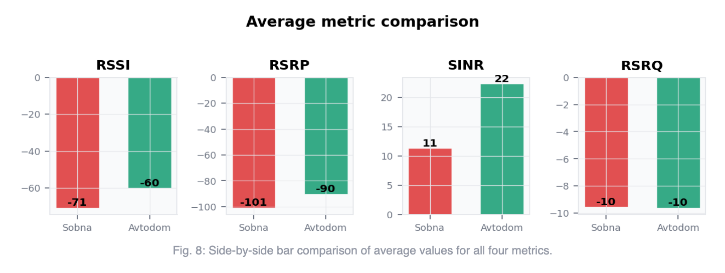

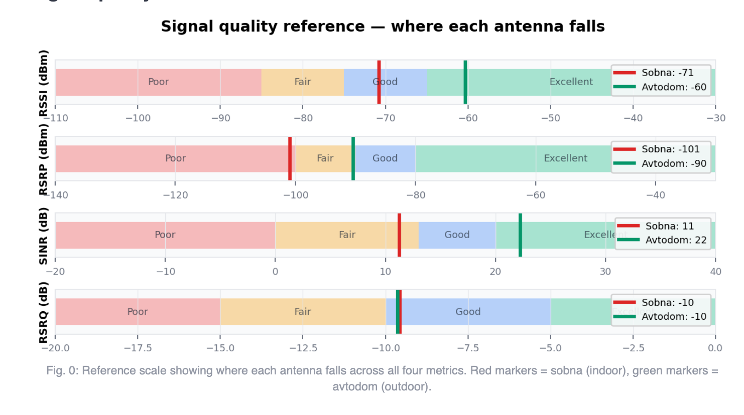

Hey, thanks everyone for support!
I have collected an hour long gsmctl -q readings (30s intervals) for each antenna (original ones and Panorama one with 30cm cable length) and put the results into Claude to prepare me some comparison and the following are the results (Avtodom is Panorama antenna, Sobna is original antenna)
I have paid attention to connect all Panorama connectors in appropriate order (Class A → ANT0, Class B → ANT1, …) and these were the results. As it seems, everything is working normal (no USB disconnects in dmesg, wireguard tunnel stable, wifi working as expected).
Additionally, I have ran /usr/bin/wireguard_watchdog to ensure the stability of wireguard tunnel, if that is somehow related.
Can there be something else that I’ve accidently changed with multiple reboots that impacted the performance? I haven’t change any other configuration (just the watchdog)…
I am still puzzled why would mobile signal strenght cause USB disconnects, though. When modem will be on the road, the signal strength will definitely change :confused:
Big thank you in advance!
