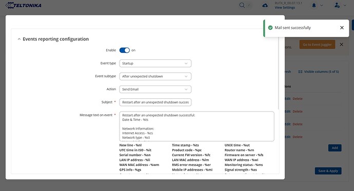

If you continue to experience the issue, could you provide more details about your configuration? Specifically, it would be helpful to know what events reporting you have set up, what email provider you’re using, and any relevant screenshots of your settings, if possible.
These event reporting rules worked perfectly before my 7.13 firmware upgrade.
I have now deleted and recreated my event reporting rules.
Sending test emails works perfectly, and the recipient receives the test emails.
One of the rules i can test in reality is the “Unexpected Shutdown Event”. On starting up, the text message is sent and received, but the email is not received by the recipient. Don’t know for sure if it actually gets sent though.

Silly me, i can check to see if the email is sent by having a look in my Webmails sent box… No sent email exists, and no email received in the inbox either.
Sending a test email works, the sent email is in my Webmails sent box and gets delivered into my inbox.
