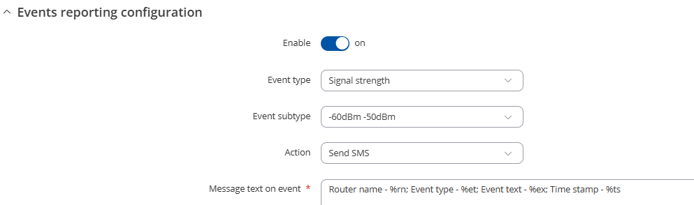

To receive a report when the signal strength drops below or falls within a specified dBm range, you can use the Event Reporting feature (Services → Events Reporting). This allows you to configure email or SMS notifications when such an event occurs:
More details on this functionality can be found here.
Additionally, you may find the Low Signal Reconnect function (Network → Mobile → Connection) useful as well, which relates to your described created rule. This feature enables automatic modem operator connection resets when the signal strength falls below a defined threshold.

This is the rule i tried and received a number of texts saying the signal strength was better than -50dBm whereas i was hoping to have a rule whereby i could get a message when the signal strength was worse than say -60dBn only. My signal strength is almost always better than -50dBm.
In this case, there’s -75 dBm -60 dBm range:
Does the rule you have chosen mean:
If the signal strength falls into the range 75 to 60 you get a message?
If the signal strength falls outside the range 75 to 60 you get a message?
Both!?
Asking if it’s possible in future to choose /define a threshold of say a value of 60 as an example and choose if it goes above or below this value for a defined amount of time to get a message. A lot less messages unless the user value is too close to what is their normal signal range.
The event report triggers only when the signal strength falls within the specified range.
