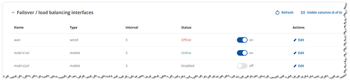

Hello @malina79,

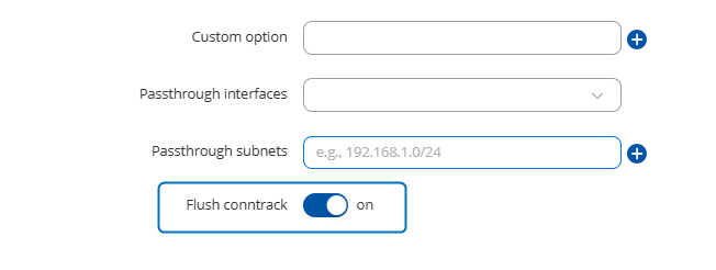

Could you please check whether the Flush connections option is enabled on your Failover interfaces, as well as the Flush conntrack option in IPsec advanced settings?
Failover flush connections on setting
IPsec Flush conntrack setting
If these options are currently disabled, kindly enable them and test the failover behavior alongside your IPsec setup.
Let me know if that helps.
HI Martynas.
  • Failover interfaces (/network/failover/mwan) both have “Flush connections on” - all 4 options are on.
  • My IPSec (/services/vpn/ipsec#id=VLAN3 → Advanced Settings: Flush conntrack) was OFF, but I have changed it to ON.
    Unfortunetelly it didnt helped, I did test 2 times with device restart just in case. Do you have any other ideas ?

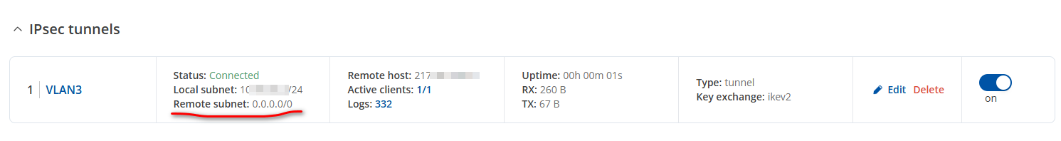

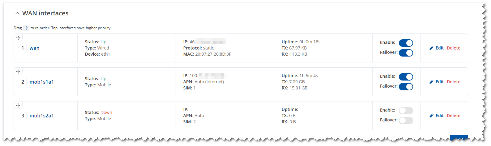

I am using 2 VLANS as local LAN networks, only 2nd VLAN is beeing connected via IPSec and fully routed to the tunnel (with 0.0.0.0 mask). 1st VLAN is regural LAN network without vpn, just behing NAT on WAN interface.
Now I imagine. when I unplug optical wire from modem (modem is bridged with LAN cable to WAN interface), it shoud trigger failover mechanism, and change default WAN interface to Mobile1 (which is of course tested and working fine). And it is - Mobile interface status is changed from Standby to Online, but … routing is not working.
I am doing tests (pingi from screens) from 1st VLAN which is not using ipsec and - I am trying to reach public IP of course.
