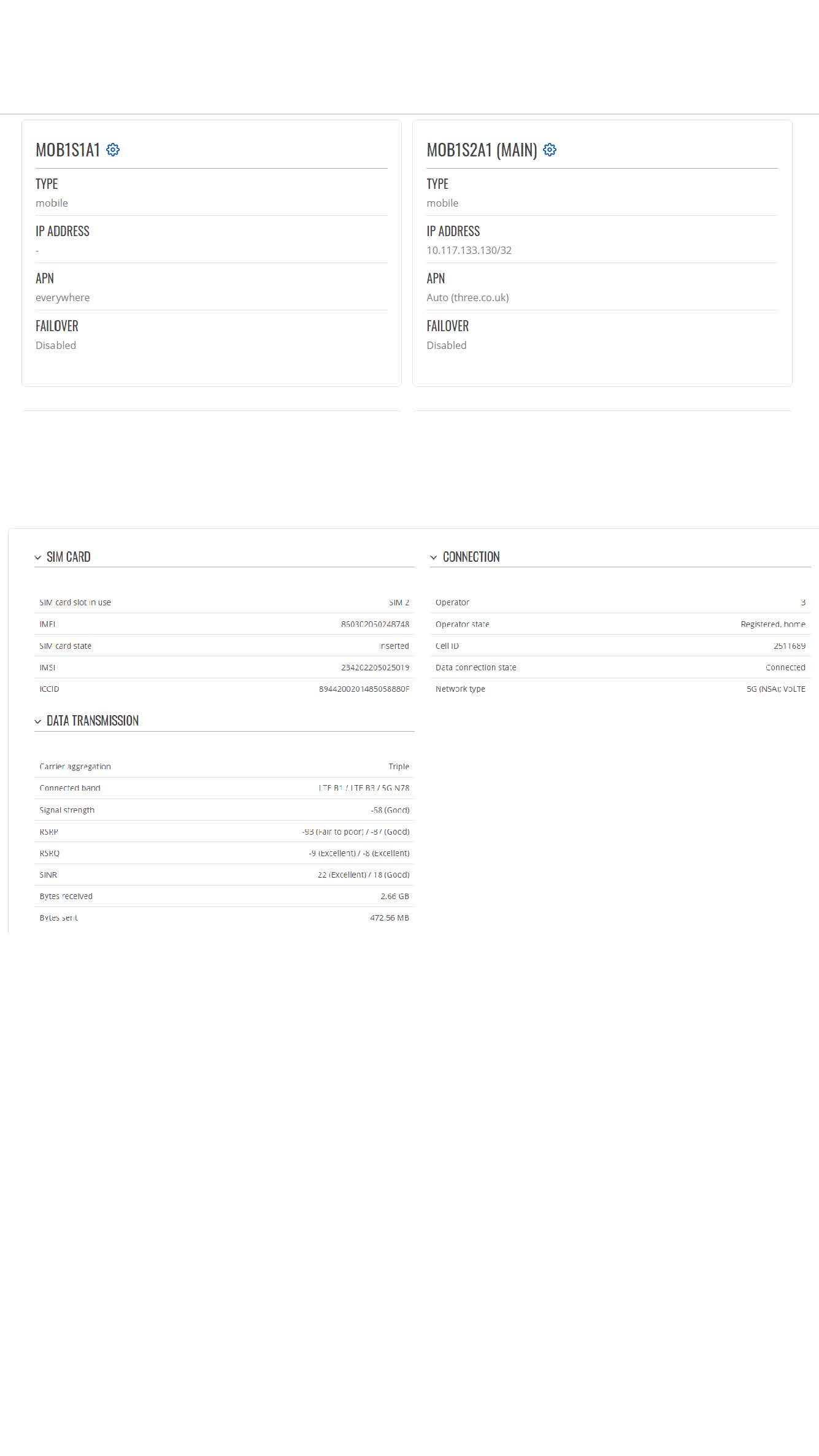

I am based in the UK and have a ‘Three’ SIM and an ‘EE’ SIM. The Three SIM is recognised and works fine, but the EE SIM is not recognised. I have swapped the SIMs around in the slots and carried out reboots / factory reboot. The green light for the slot (whether it’s 1 or 2) containing the EE SIM does not light up after a reboot.
Firmware: RUTX_R_00.07.04.5
Internal modem: RG501QEUAAR12A08M4G_04.200.04.200
Perhaps you could check if the SIM works properly in a mobile phone? If it does, I’ll ask you to insert the EE SIM into the device, wait around a minute, then navigate to System → Administration → Troubleshoot, press the Show button on System logs and copy the logs from the past few minutes. Make sure to remove any sensitive information and paste the logs in the next comment. This will help me identify what the issue could be.
Hi Daumantas
The EE SIM works fine in my mobile. I called up the show log but it looks like there is a limit in the amount of text I can send. Here is the first minute:

I will ask you to take a screenshot of the Status → Overview Mobile section tile, as well as Status → Network → Mobile and attach them to your next comment. Make sure to remove any sensitive information.
Hi Daumantas
Please see screenshots attached.
Just to clarify, RUTX50 only has one modem, so only one SIM can be active at the same time. If you’d like both SIMs to be active, RUTX12 is currently the only device from our lineup which offers this functionality.
In your case, you can configure SIM Switch, which will automatically change between these SIMs in case one of them loses the connection.
