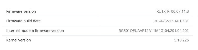

@Martynas thanks for reply.
Please check the photo.
We restart the device.
Try to upload the firmware but we get that error
and at system logs
