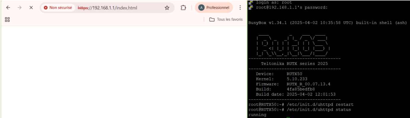

When I put “192.168.1.1/index.html” in the URL it loads for about 5 minutes then stays blank as you can see below :

Thank you for your reply, I did manage to access the device via SSH but the commands you provided didn’t improve the situation.
As you can see below the menu.json file has been removed :

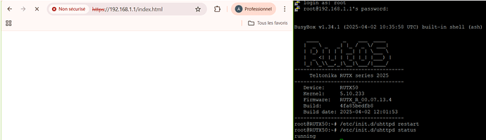

The restart of the HTTP server, and it’s status says it is running :
Something strange happened when I restarted the HTTP server.
After a few minutes the login page did load but when I tried to connect using the password provided under the router I got an error “the device is not reachable” or something like that. I refreshed the page and now it’s blank again.
(I was still connected via SSH and could still interact with the device so it definetely was reachable when the error came).
