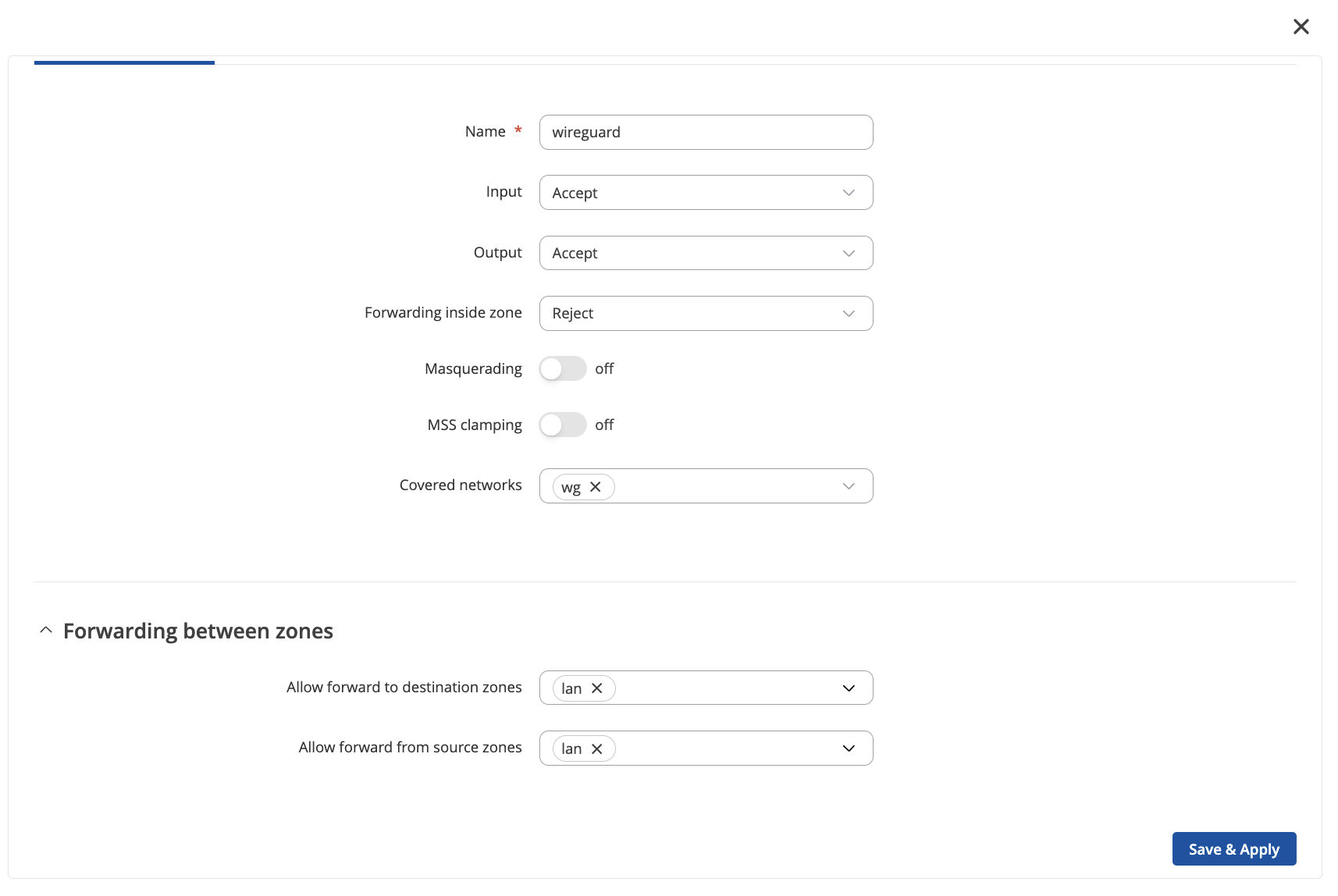

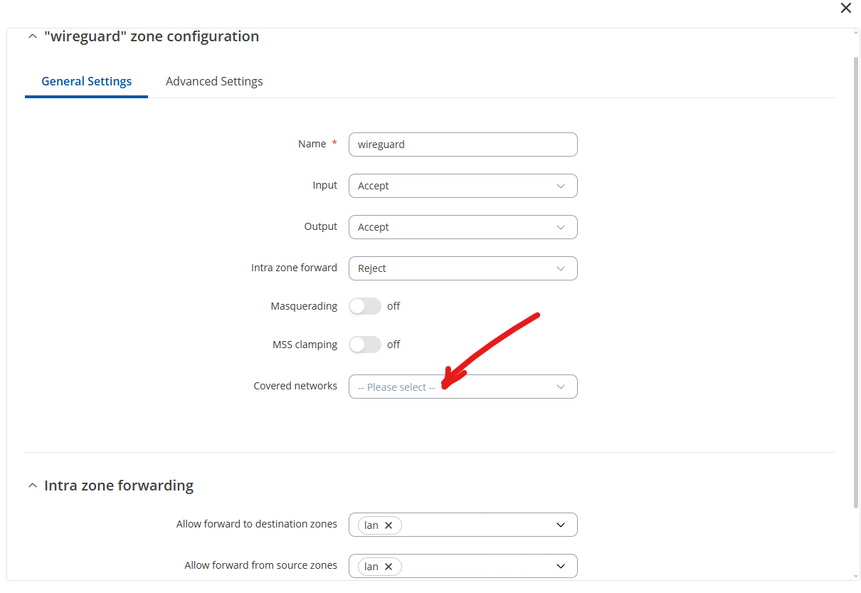

Your wireguard firewall zone should look similar to this. You need to select your Wireguard tunnel in the box indicated by the red arrow.
thanks for your reply. I tried to set it up as per your image, but I am still not seing any handshakes, so I am not sure if it is even trying to connect.

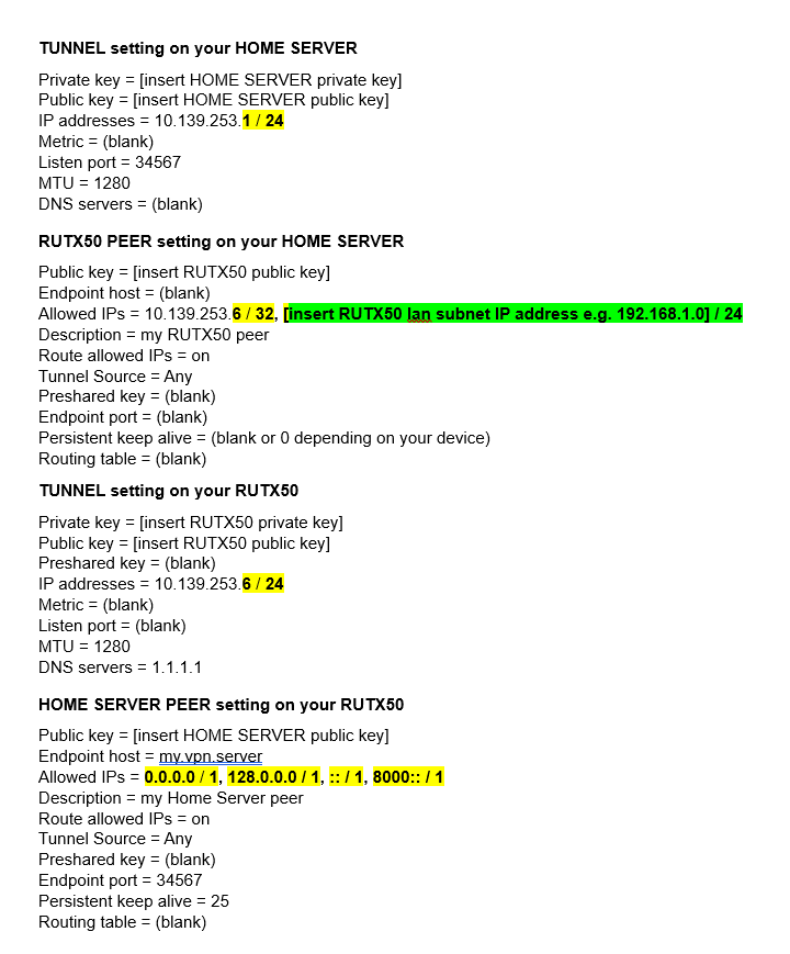

OK strip it back to basics. The below configuration assumes …
a) The tunnel IP on your Home Server is 10.139.253.1
b) The tunnel IP on your RUTX50 is 10.139.253.6
c) Your home internet provider has given you a public IP
d) The RUTX50 service provider has given you an IP that is behind CGNAT and is not Public
e) The RUTX50 always initiates the tunnel connection
f) You want any device attached to the lan segment on the RUTX50, access to all subnets on your Home Server (firewall rules allowing).
g) There is no pre-shared key
h) There are no IP subnet overlaps on the Home Server / RUTX50 combo.
EDIT: The settings are changed from the original post and are highlighted in GREEN.
Thank you for looking into my issue and providing this.
No problem … once you have the simple configuration working, then you can start altering things such as DNS Server, Pre-shared key etc.
Leave the MTU at 1280.
Depending on the device at your home location, some of the settings on your home server, may not be present.
I’ve slighly changed the settings, and have ammended the original post.
