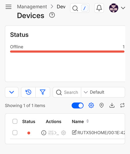

After upgrading to 7.13.4 in RMS the RUTX50 remains off-line but I have a connection. I can’t remotely access it anymore but I have an online status with my iot items. Somehow I can’t get it out of this mode. Even rebooting and down grading didn’t help.
What to do?

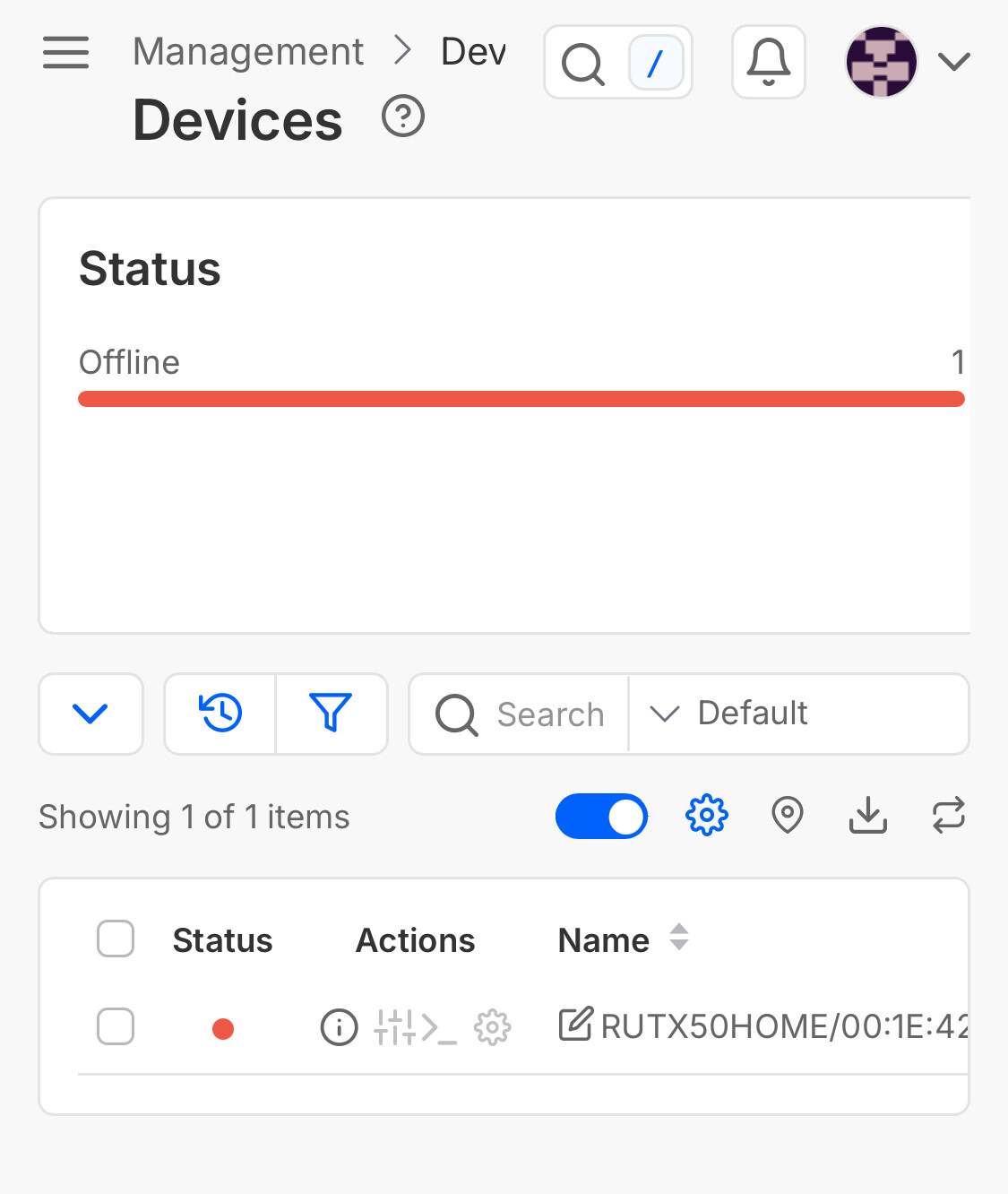

I have it again. I am offline but I can see my iot (home assistant) working. I can powercycle it but that doesn’t help. It stays offline after the powercycle.
It’s very strange. I run 7.14.
The browse change had no impact. It also fails on my phone.
I don’t receive any errors. I have to be local probably to log in and see what’s wrong. I can’t reboot it via a modbus service or via a self restarting switch but nothing helps.
If I try to login via remote access it keeps spinning which normally gives a time-out if you are offline. In this case it doesn’t connect but doesn’t time out either.
I can’t upload a backup. I tried that too.
