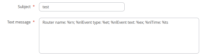

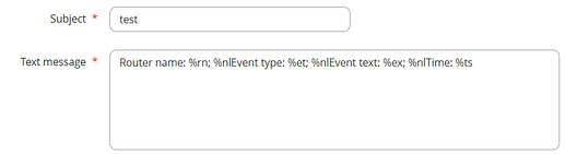

To receive the text in your preferred format with proper line breaks, %nl should be added in a single line before every variable as shown in the following screenshot:

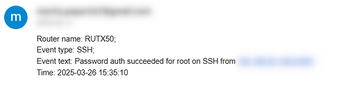

Once configured this way, the email text will be displayed in your required format:
Let me know if you need further assistance!
Unfortunately this is NOT working as the mail, which is being sent, is NOT in html format but in plain text format only. Thus, the new line command is NOT being recognized. I again tried it, as you suggested but the result stays the same. To resolve this issue it will be necessary, to switch the mail format of Juggler from plain text into html format. Better would be a switch, that the user can chose between both formats.
