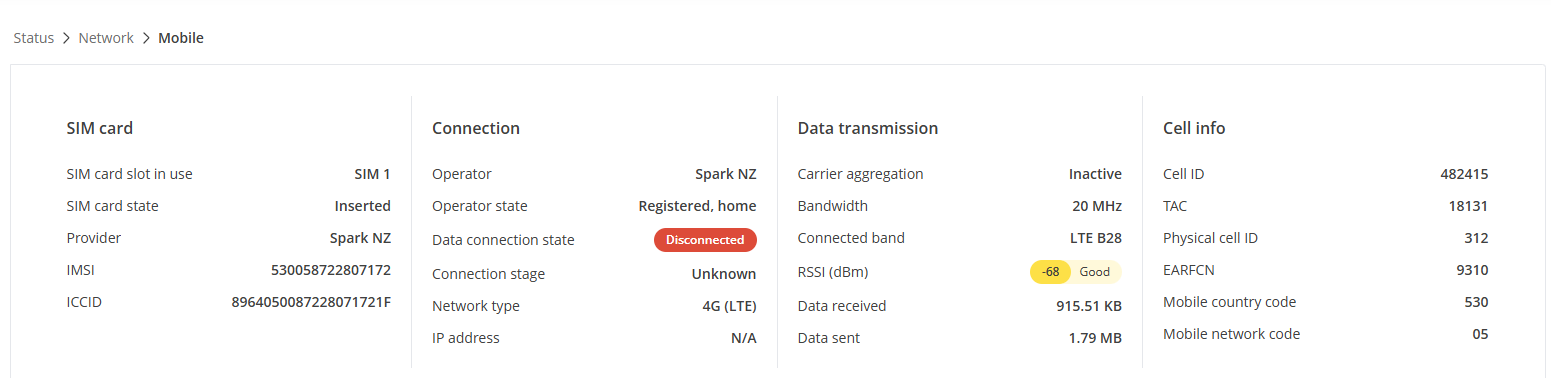

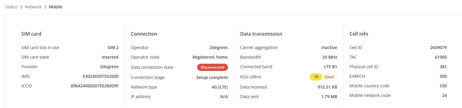

Recently did a modem firmware update that was offered in the webUI and now neither sim manages to get a data connection. Both have network connections, but there is just no data.
I have tested the SIM cards in other devices, and they both work perfectly. I also have 4G coverage and have tried using them in various locations. The SIM cards are from two different networks, and both functioned well before the update. Additionally, I have performed a factory reset on the device twice, but I still have not had any success.
  • Internal modem firmware version: EG12EAPAR01A09M4G_01.001.01.001

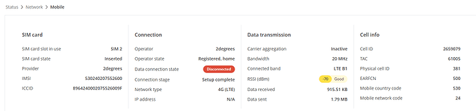

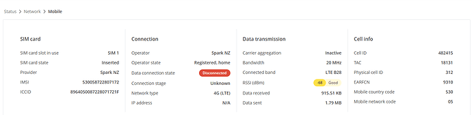

I have also tried the cli updater but get the following on both sims
error: Failed to handle AT exec. ERR: Not found
Also from the other modem
Same issue as the other sim above
