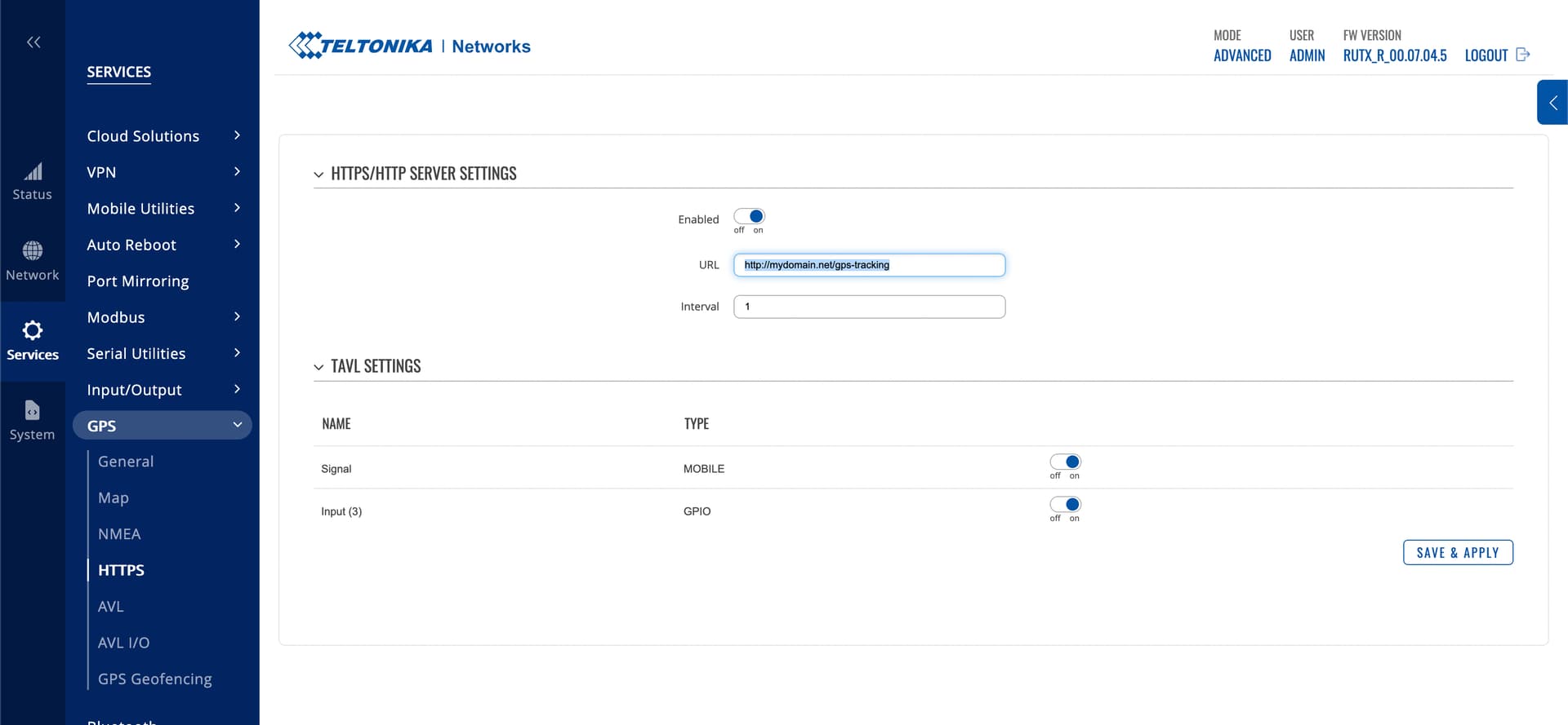

I’m trying to develope my own software, if I can dot it more or less in a easy way. I see this GPS / https options in the router configuration (screenshot attached), and with no help/documentation anyway, I think that this can be to send tracking data in a format like json or similar. Am I wrong? It’s possible do what I need?
Thanks!
GPS data to HTTPS server simply formwards NMEA sentencia via HTTP(S) POST, there’s no JSON.

If I receive the data via POST, it’s perfect also. The problem that I have is that the router isn’t calling the URL. I have a log that save all json/post data received (even if all is empty), and if I open the URL with the browser, I have data in the log, but never receive a request from the router.
I see in your screenshot you are sending data to a local IP. I’m trying to send data to an external host, with the domain name, no the IP (it’s a shared IP). Can be this the problem? There is a way to solve it?
