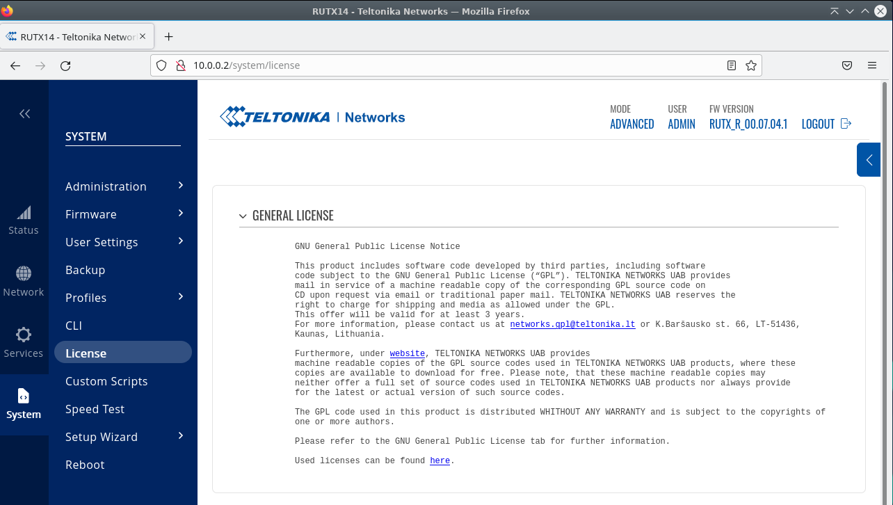

ok thanks, but are you sure that AVL sender in RUTX14 is not open source? i accidentally stumbled upon the License page in my RUTX14 and it says it is GPL:
which parts are indeed GPL and which are not?
Correct, parts of the software are GPL:
This product includes software code developed by third parties, including software
code subject to the GNU General Public License (“GPL”).
If any more information about our GPL policy is required, please contact us at networks.gpl@teltonika.lt
We provide an SDK for anyone who decides to expand upon our firmware: Software Development Kit - Teltonika Networks Wiki
Instructions on how to add packages and compile the firmware can be found here: RUTOS Software Development Kit instructions - Teltonika Networks Wiki
