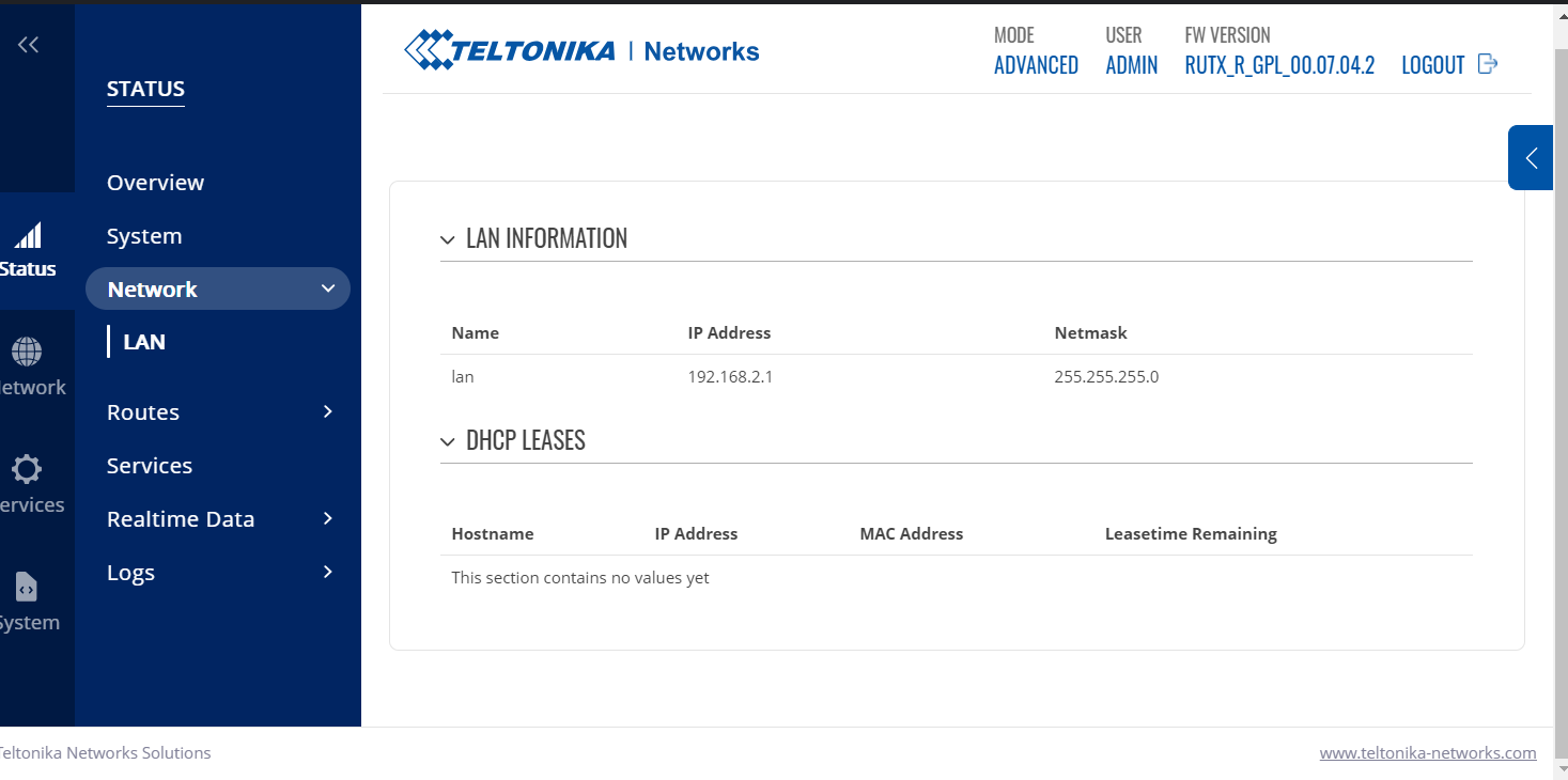

Hello
No topology tab under status - network.
Please advise.
This device is still running 07.04.x firmware, please update it to the latest, as the topology map was added in the 07.05.x release.
